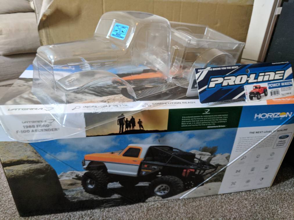

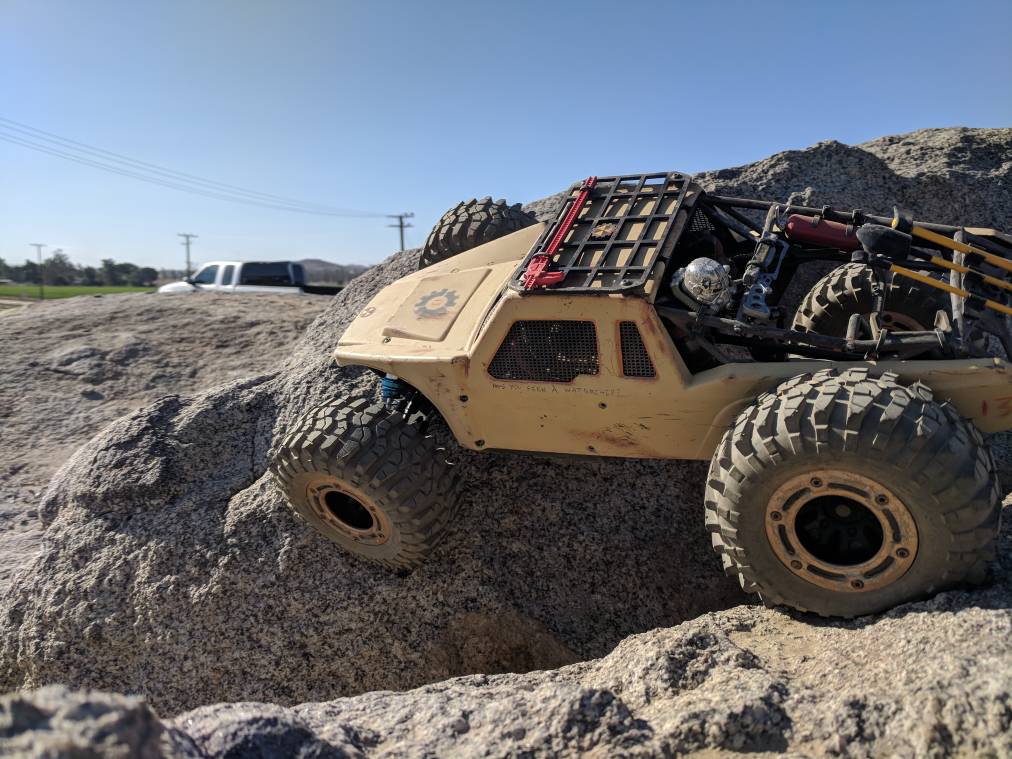

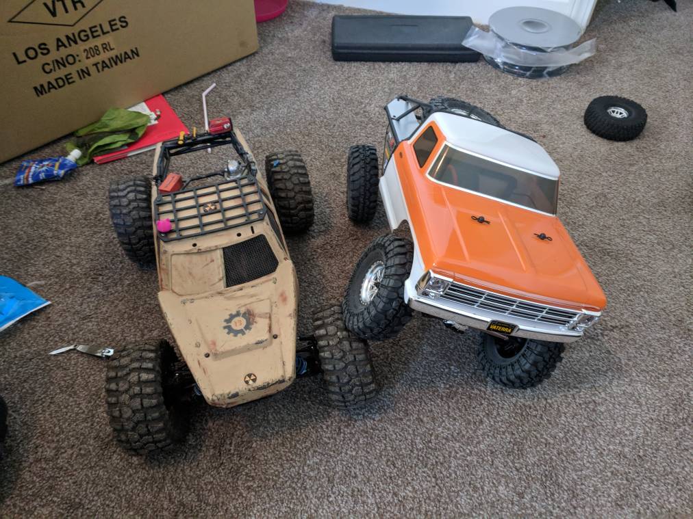

Building a Fallout-themed Power Wagon ascender crawler to compliment my Vault 13 Twin Hammer trail truck. The plan for the Ascender is as a tow rig for the TH and scale crawler.
Starting with a BND ascender F100. Currently collecting parts and getting started on the body.
Here is a little teaser and a look at my Twin Hammer build.

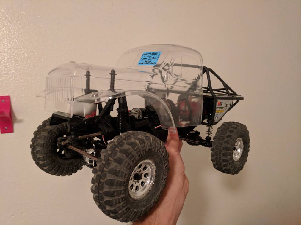

Thanks! That TH is pretty beat up, here is a shot when it was fresh.
I considered the blue Vualt-tec truck, but I'm going to do a green military truck repurposed by the brotherhood of steel theme. I'm actually up on camp Pendleton, do most my crawling with the inland empire group or up in LA.

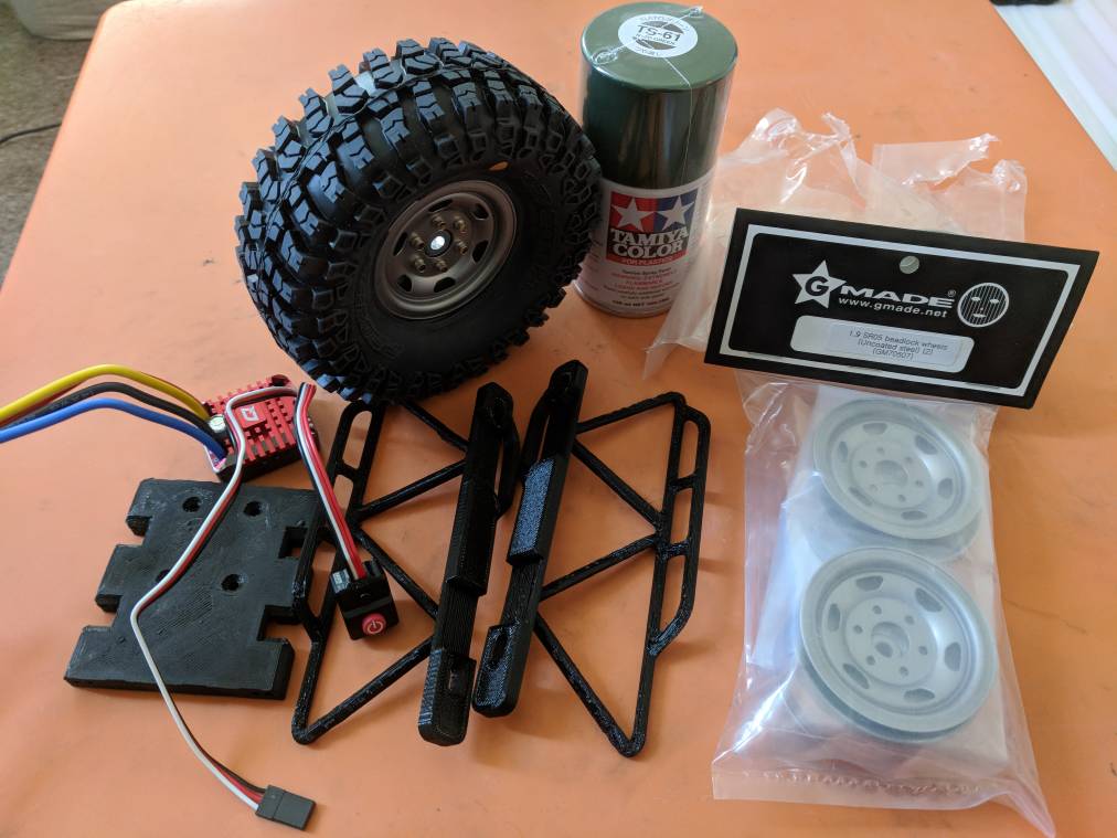

Got some parts in today! Been running my 3D printer like crazy making stuff, testing stuff, and seeing what I can adapt to the power wagon body.
On the table you see:
GMade sr05 beadlocks. These things are solid and heavy. My first time assembling internal bead locks, so took me a minute to realize how to use the supplied long screws to hold it together. Turned out nice. These ones are unfinished steel so hopefully will weather nicely.
Proline flatiron 1.9xl. run the 2.2 m3 compound on my TH and love them, decided to try the new compound.
Hobbywing quickrun 1080. Heard nothing but good about this, thought I'd try.
3d printed rock sliders and low profile skid plate. Thanks to @callaway for these sliders! They turned out really nice. They needed to be scaled down for the more narrow Power Wagon body. Currently I have them printed at 41mm each, which is about 2mm too short on each side, as it ends up squeezing the body. Not bad for a guess on the size though! We will see how these do!
GMade sr05 beadlocks. These things are solid and heavy. My first time assembling an internal beadlocks, so took my a minute to realize how to use the supplied long screws to hold it together. Turned out nice. These ones are unfinished steel so hopefully will weather nicely.
3d printed rock sliders and low profile skid plate. We will see how these do!

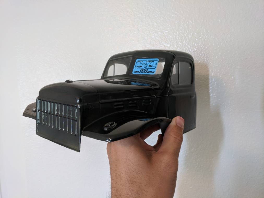

Made some progress today. On the floor of my office because my workbench is covered in 1:1 parts and my kitchen table is covered in wife crafts! Haha.

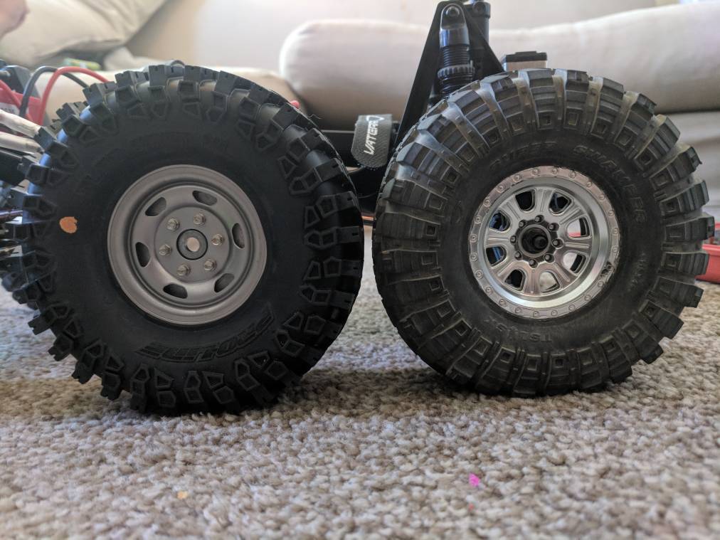

Got all the tires mounted on the wheels. Not sure how I feel about the internal beadlocks. It was pretty tough to get all the beads well locked in place, and I have a few sections where the bead isn't pinched well. I foresee these beads slipping in the future and me disassembling for repair.
Installed the 1080 esc, havne't wired it up yet though.

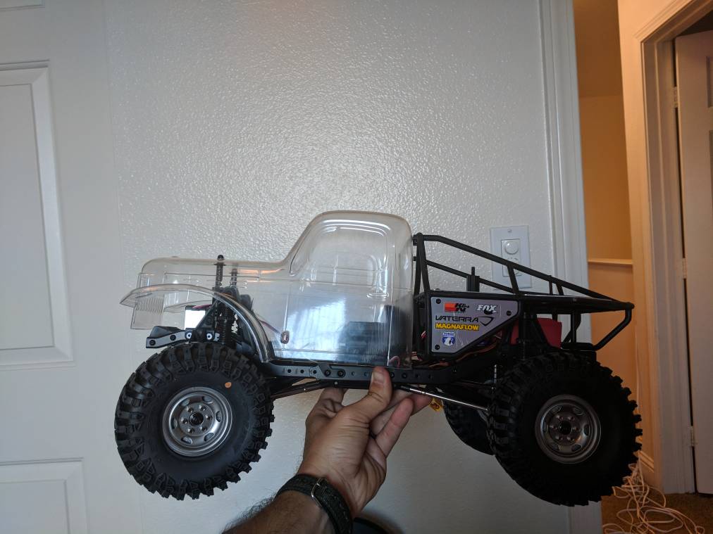

And most importantly I got the wheelbase stretched to 314 mm. Wasn't hard just time-consuming! If anyone ever does this, and doesn't notice, the threaded bars that hold the upper and lower links to the link ends have 1.5mm hex slots for unscrewing them. I still had to use a pair of needlenose pliers on a few of them that ended up threading out the wrong end.
Also got the body drilled and started getting bit mounted. Just need to drill the holes to attach the cage/bed now.

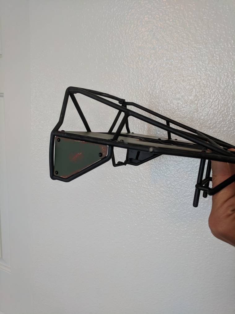

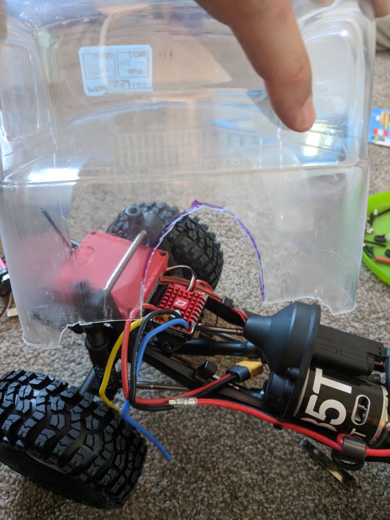

While I wait for the rest of my paint to come in, I ordered a new 55t RC4WD motor to replace the stock 35t. If I like the 55t motor I'll probably replace with a nicer rebuildable one, any recommendations?

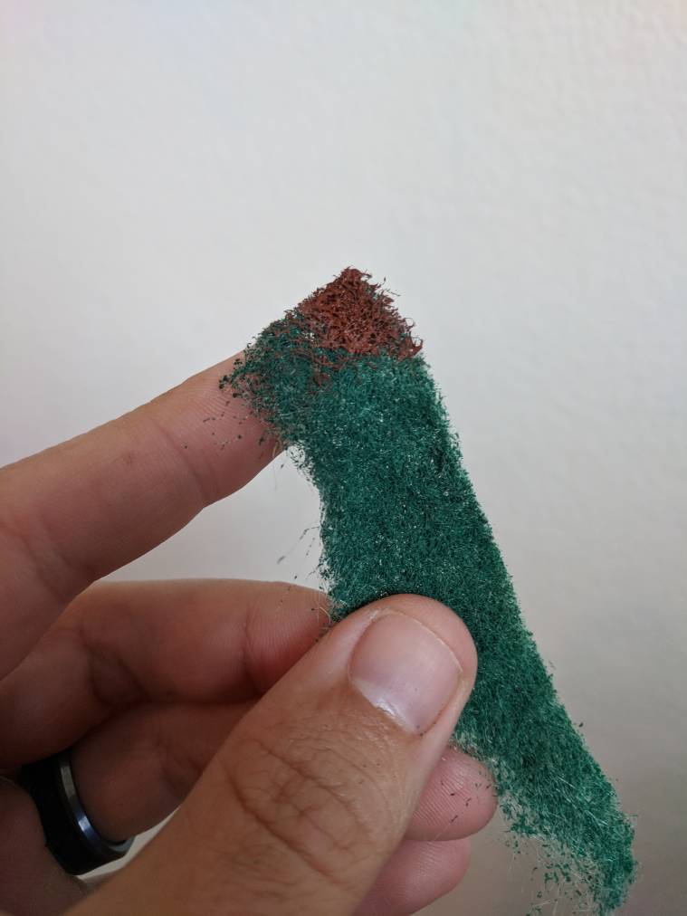

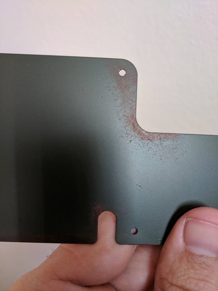

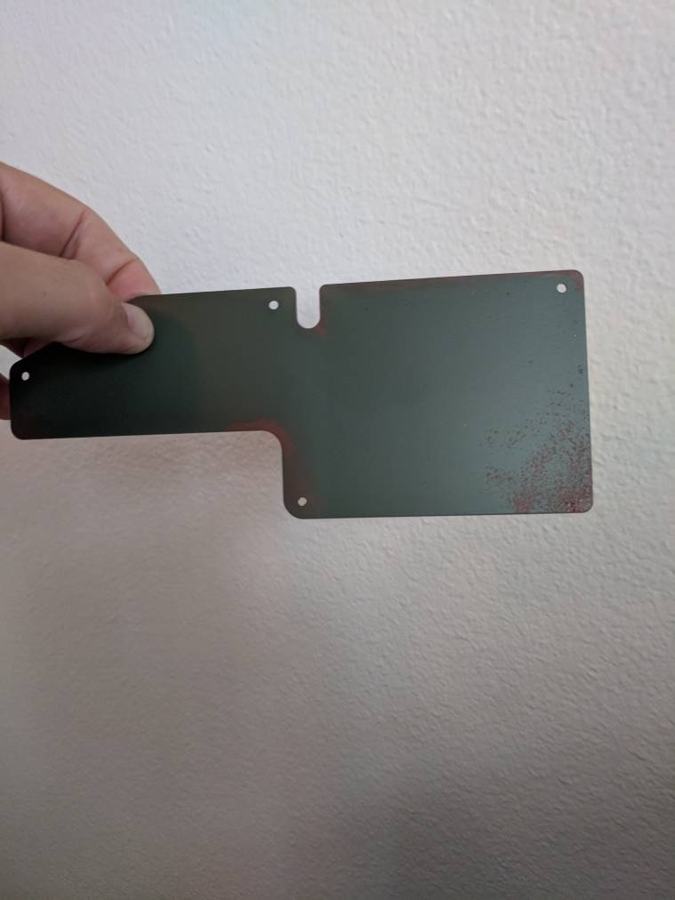

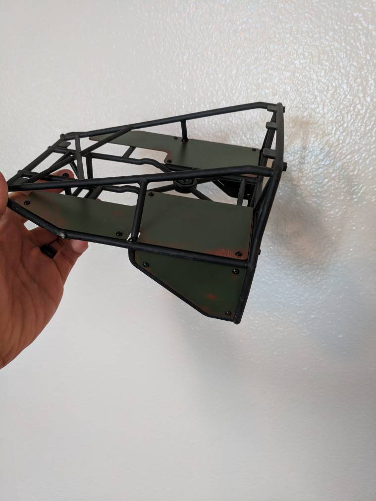

I did get started painting the rear cage and flat bed though. I initially used the same rust technique i used for the twin hammers, but it didn't work very well. Because i painted the TH with a brush and heavier acrylic paint it was textured, so the dry brushing of rust paint resulted in a nice textured look.
The metal panels were sprayed and had a much smoother finish, so the dry brushing didn't work well. Looking for something with texture, I grabbed a green scrub pad out of the kitchen (unused) and tore a piece off. I dipped this in the rust paint, dabbed the excess off on a tissue, then blotted the metal to get the rough, textured look. Worked out quite well! Now on to the pics.

How could someone not click on a thread title like this? I really like that the panels aren't heavily oxidized/ relic... just the right amount. Really cool project.
REALLY nice job on the panels, my man! Couldn't ask for a better finish... I've also got a second cab & cage to work one for my K10, but I like the '72 Chevy so much I just got another.
It's likely to be more of a shelf queen, going the opposite direction from yours. My original panels were brush painted black to match the hood I also painted, 'cause everyone has that all-yellow cab!

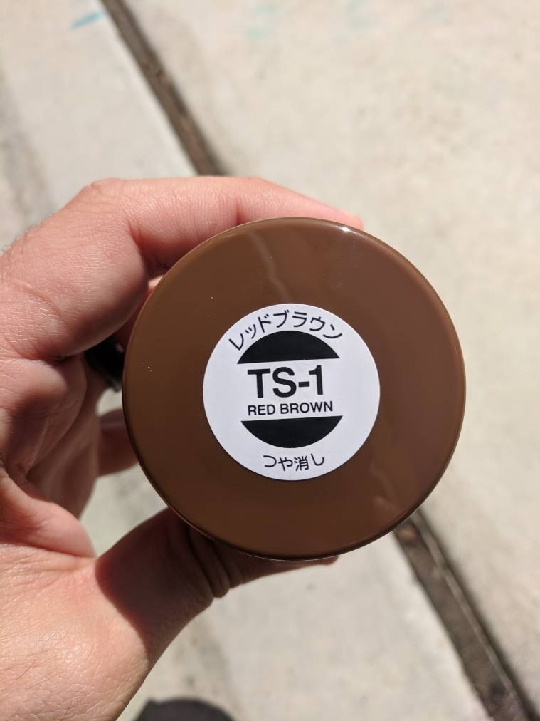

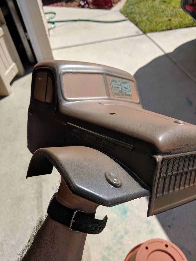

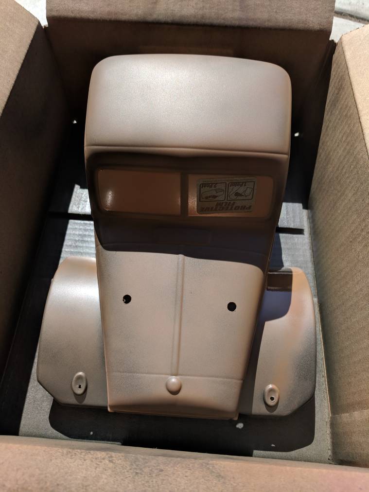

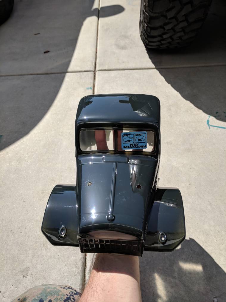

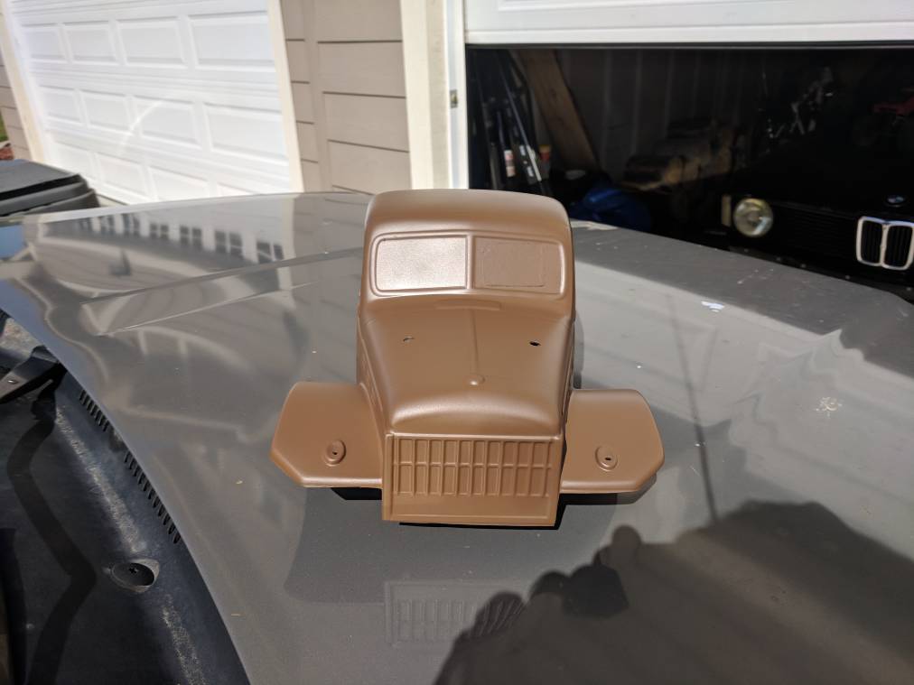

Got some body clean up done and started painting. Did the underside in NATO black to set it up to show through when it inevitably scratches through. After the black I did the outside in a rust, red brown color for the weathering that will be underneath.
The intent moving from here is NATO green, using a variety if methods for rust and weather to include salt chipping, sponge chipping, dry brushing, and corner sanding.
It won't be perfect, but I'm not much a perfectionist nor experienced in painting.
