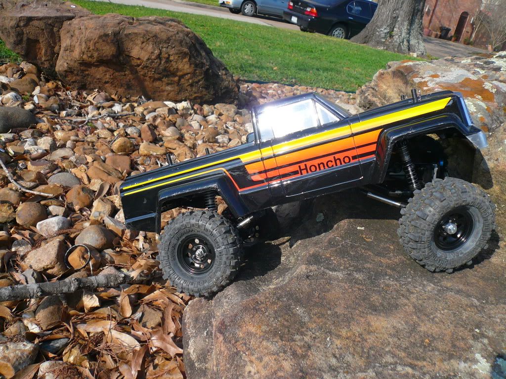

Is anyone else running proline powerstroke shocks on their crawler and finding them way to stiff?
Im having a hard time finding replacement springs of different rates. The local hobby shop doesnt have squat for anything but planes on hand. Any advice guys?
