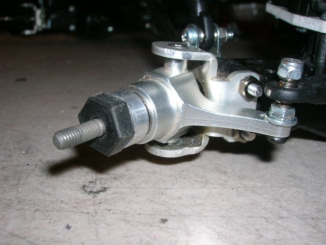

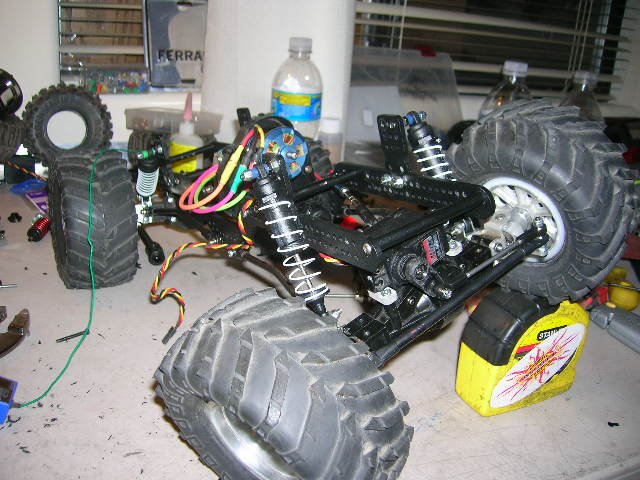

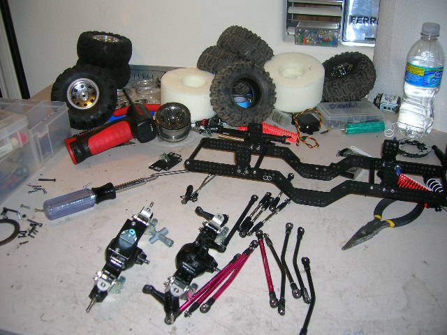

i was sitting in my rc room this morning and started looking at all the extra parts ive got laying around. an MFM chassis (yeah i abondoned project ol skool, phucking ADD) a set of locked tlt axles, tons of traxxas links, servo mount plates, wheels tires, 3.5" shocks, losi white and gray springs, MSD ultimate wideners, two pede trannies, 2 or 3 645MG servos, etc....
so i grabbed a couple of sam adams, hit shuffle on itunes and started throwing this together... heres what i accomplished today.
specs thus far:
MFM black chassis
locked TLTs
MSD wideners
fatrock Cs
aluminum knuckles
645MG steer servo
steel revo pushrods for lower links
aluminum revo pushrods for upper rear links
steel adjustable jato turnbuckles for upper front links
traxxas 3.5" shocks
losi white springs on the front
losi grey springs on the rear
losi 80wt oil in the rear
losi 20wt oil in the front
pede front wheels
mashers with star cut foams because they were glued before memory foams got big. lol.

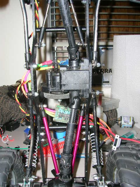

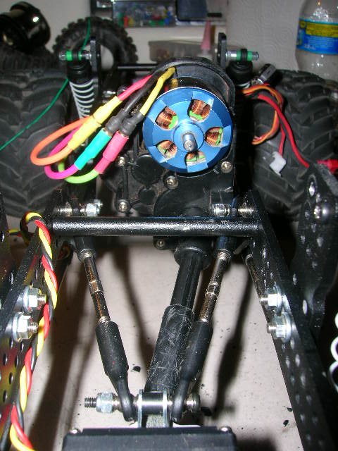

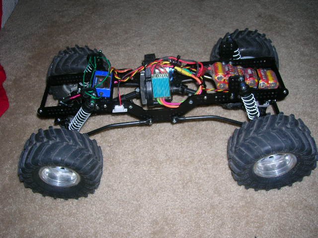

well leftover is alive! i decided to stick with the leftover theme and make one of the stampede transmissions work. its mounted vertically which im not crazy about but it works and theres surprisingly almost no twist!
i threw an extra quark/outrunner in it with an airtronics receiver. i had to trim up the old pede to make this motor fit but its all good now."thumbsup" its not the prettiest thing ive ever built but it works.
still not sure on the body though. none of my old beater bodies really look right on it.

Nice use of leftovers, that is my specialty, I enjoy using what I have laying around to put a truck together, it takes a little more creativity to make it work usually. I think a used beater body would look just right on there, recycling is good, right:lol: and it flows with your theme"thumbsup"
