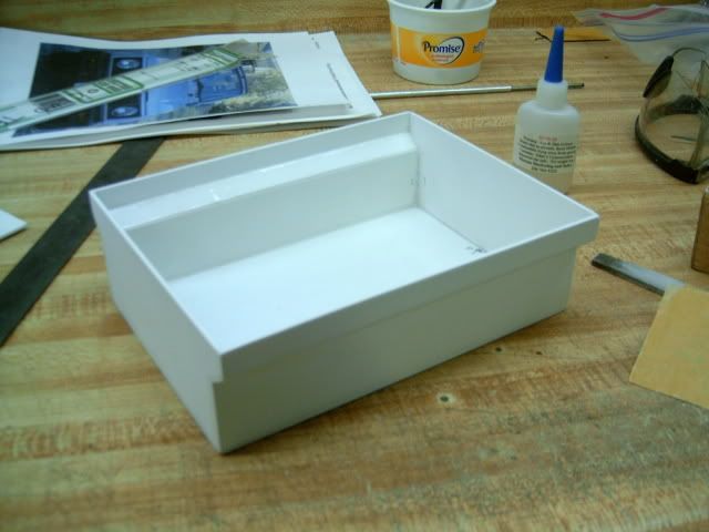

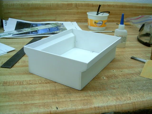

After taking measurments from a bunch of pictures online as well as my actual trailer, I broke out some scrap styrene and whipped up a few test panels..
Heres the basic design after gluing it all together

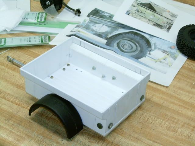

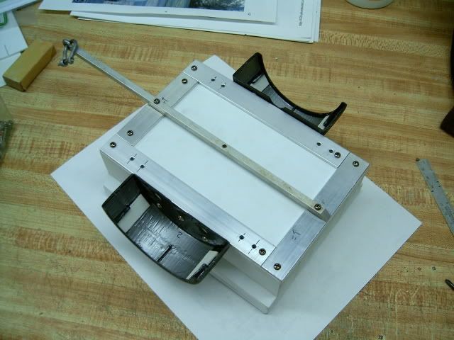

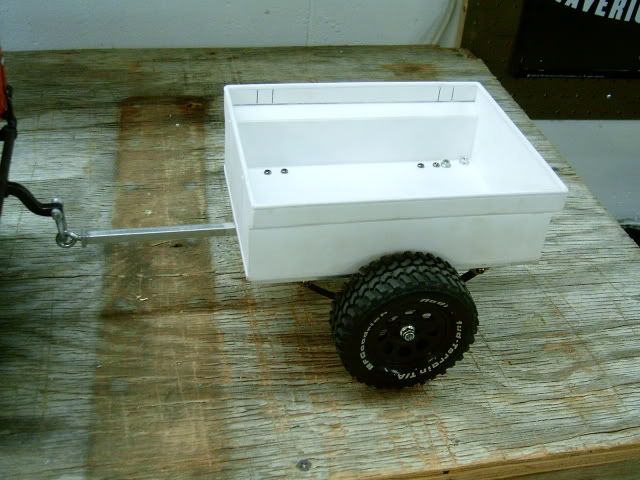

Then I built up an aluminum lower subframe, and came up with this idea for the axle. Hilift leafsprings, leftover stock hilift pivot points ( forget what exact parts these were, but I had ALOT of them extra in the parts bin, and they worked perfectly..) some HPI stock car rims, and some aluminum tubing and threaded axle shaft.
Here it is mocked up on the chassis, along with the aluminum draw bar.

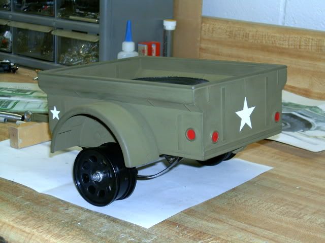

Next up was how to make scale looking rounded fenders like on the real 1:1. then I had another brainstorm, and dug thru the parts bin again.. I came out with 2 "spare" tire covers from 2 Newbright JK jeeps I had built.. PERFECT..!!!! I cut them in half, glued the sections together and test fitted them, and they fit like clockwork.. :twisted: ( seems as if they were "made" for this idea..LOL)
Here is the unfinished business end of things below..

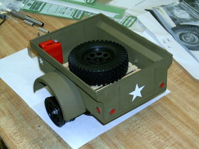

Cut out some inner bed louvers....
And added a few more details to the bedsides and inner bed panels as well as adding some plastic taillights I stole from another old vintage toy I had laying around...
Next up is to strip it all back down, change out the hardware so its less visible, and then paint it O.D. Green, slap some wheels on it and its time to hit the trails..!! More to come very soon..!! Stay Tuned..!

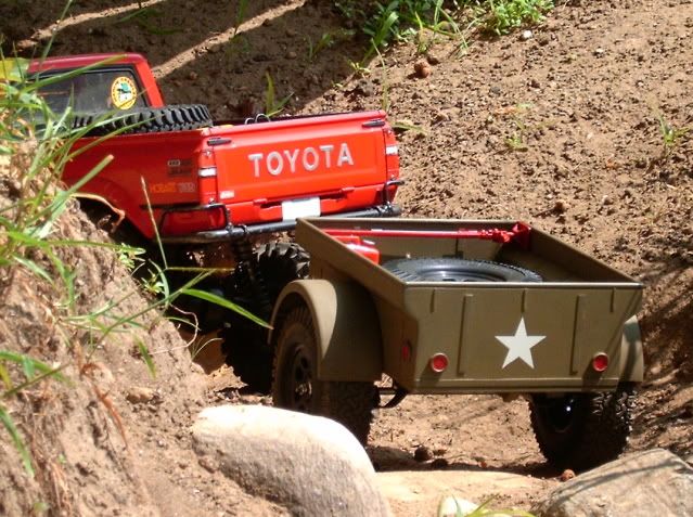

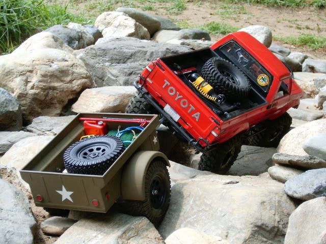

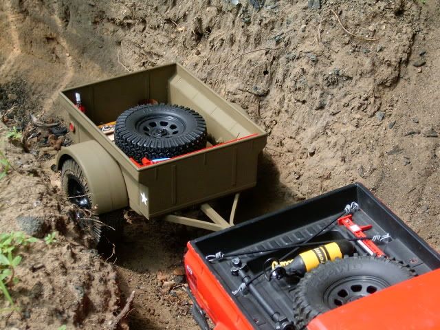

I mounted up some 1.9" Dirt Grabbers this morning, loaded it up with scale cargo, and it was off to the trails for its maiden voyage. The test rig is my old school Bruiser hybrid scaler.
All loaded up ready to go..

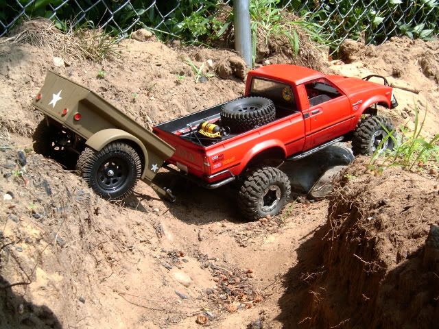

With the double pivot mounting set-up, driving it over virtually ANY angle was a breeze..!! I'll just let the pics do the talking.. :twisted:
Then I drove it thru the one of the hardest off camber and twisty sections I have at my rock course.
I was amazed to watch the truck and trailer pivot 180 degrees from each other, yet the trailer pulled thru clean each time I went thru this section. All in all, this thing worked dam near perfect.
