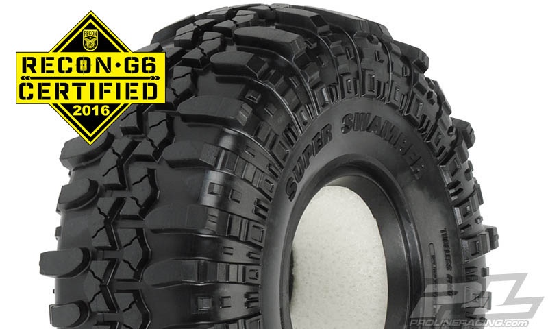

I heard that it is very difficult to mount any proline tires on vanquish wheels. Is it true? There's a video on YouTube showing that the lip of the super Swamper XL sticks out too much. Anybody have any good tips or advices? Thanks.

Buy a slightly wider rim that is easier to mount and proven to work with these tires. However, even then it's going to take a little patience and work to mount tires on beadlocks. :)

A big part of the problem mounting Proline tires is the HUGE oversized foams they come with. Once I started using CI foams in mine I no longer had a lot of trouble mounting them. I just installed a set on some ebay special wheels a couple weeks ago and had no problem.
