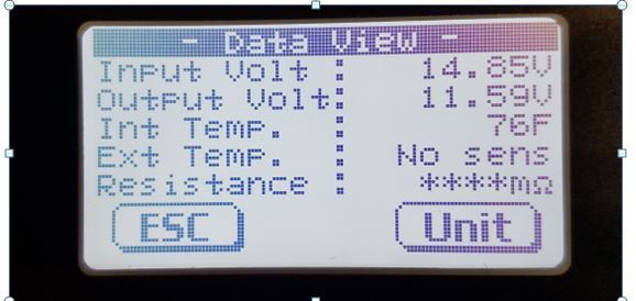

Also have a Prodigy 680 single port that reads ****. Really weird...
