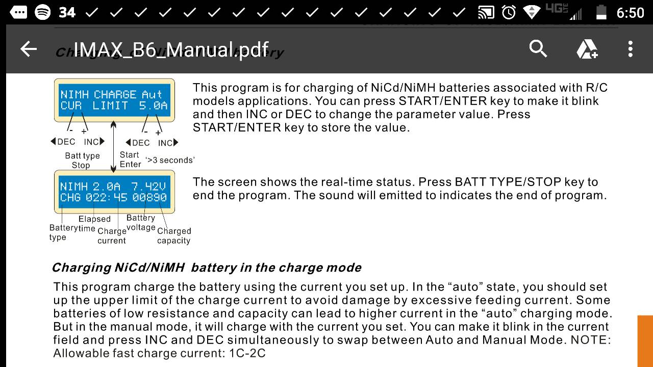

Are you sure it's in nimh charge mode?
http://www.skyrc.com/download/IMAX_B6_Manual.pdf
