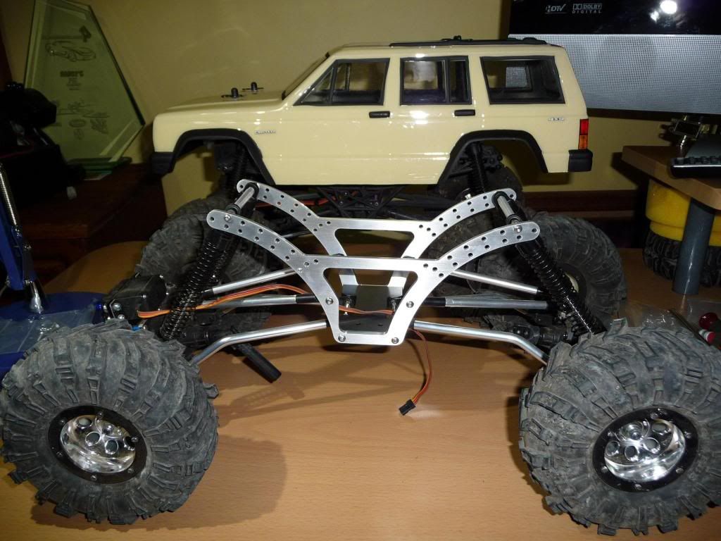

I'd think about keeping the chassis. It's a bit spendy and out of stock now. Cost me a little over a hundred to have mine shipped up from the states.
http://www.neweramodels.com/item.cgi?session_id=&part_id=8874
You could just throw a body on top and call it good. I wrapped my NRC560 in glow wire. Looks pimp at night 8).
The chassis is okay at crawling due to its 60/40 setup. But the hangup I have with it comes down to battery placement. Not much you can do about it though. As for toughness this chassis can take some major abuse. The one I received. Has fallen off mountain ledges multiple times, and not bent warped or cracked. The sweet spot about the NRC560 is your link and shock mount possibility's. I've had mine lifted, dropped, stretched, and now sits at a bit shy of 16" axle to axle.
If you'd take my opinion. To produce a scaler. Out of what you have to work with. Remove the King axles and drive shafts first. Then get a RC4WD Trail Finder or similar chassis. New Transmission that fit the chassis (Wheely King trannys are not generally loved upon,and would probably need clocking anyway). Scale shocks or leaf springs (both?) . New scale tires and maybe wheels (2.2's, 1.9's can sometimes look a little goofy on these HPI axles if not done right). Last a sweet Tamiya body to round it off (with the light kit ). You can probably reuse your servos, esc, radio, motor and battery. Might also reuse the links? Looking into lipo would be a nice upgrade path.
Here's food for thought. Buy a star on RCC. Sell the machine you have there. Take the proceeds and purchase a scaler base. Build it up. You'd have a complete custom. Without the tear down work involved here. You might get a better price whole. Then just parting this animal out. Whatever you decide to do. I think you'll have fun :) .
