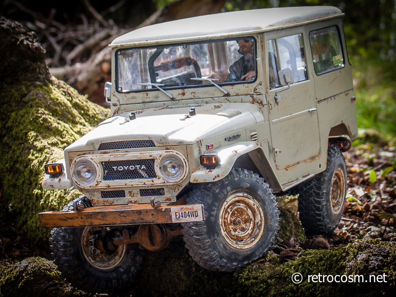

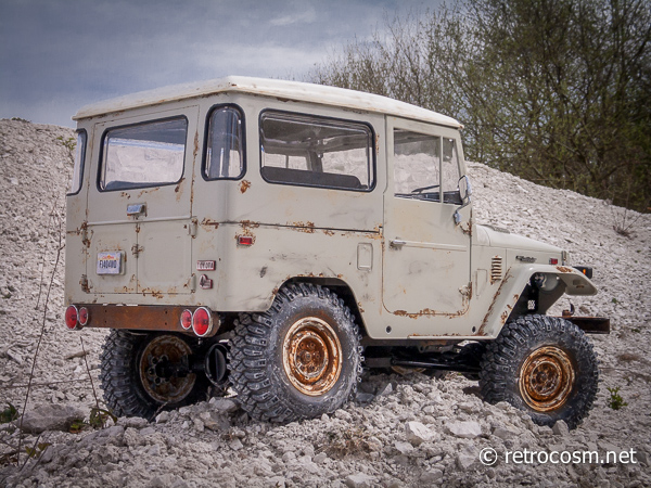

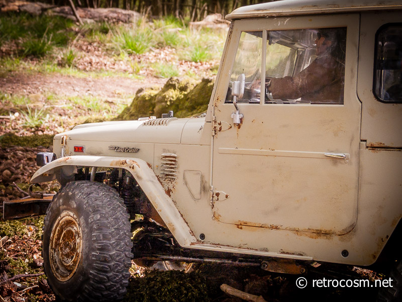

I've been experimenting with rust and weathering on my Cruiser. I'm pleased with the way it turned out, here are some pictures and video.

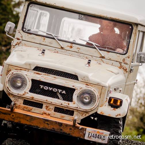

Two questions:
1. Where did you get the TOYOTA/LandCruiser logos? I've been looking everywhere for those.
2. How did you strip the chrome from the blinkers? I tried ammonia, bleach and drano.
You can find the emblems on Ebay if you search "rc4wd cruiser". They may come from Germany. Some of the others seem to sell out pretty quickly.
Super Clean degreaser will remove chrome without damaging the plastic if you soak the parts.
What is the process for weathering the body and metal? Thanks, it looks like a job very well done :)
Hi, I used two methods, the first was a rust effect kit called Scenic Rust. I used that mainly on the body. On the bumpers/chassis etc I scrapped up some rust from a drawer of rusty old nails and applied it with some of the bonder from the effects kit.
I also used a Tamiya weathering kit.
Cheers.
Two questions:
Hiya,
I got the badge kit from a seller on ebay called groundbutton. He sells out pretty quick it seems so I messaged him to let me know when he was re-listing.
I tried to strip the chrome with bleach but it didn't touch it. In the ended I sanded them and applied matt black paint.
Cheers.

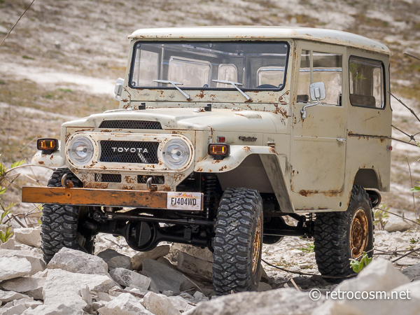

Very nice truck! Are those the plastic GMade wheels?
Hi, yes they are, I found a used set on Ebay. I've also got some hubcaps to paint up but can't currently work out how to ensure they don't all off.
