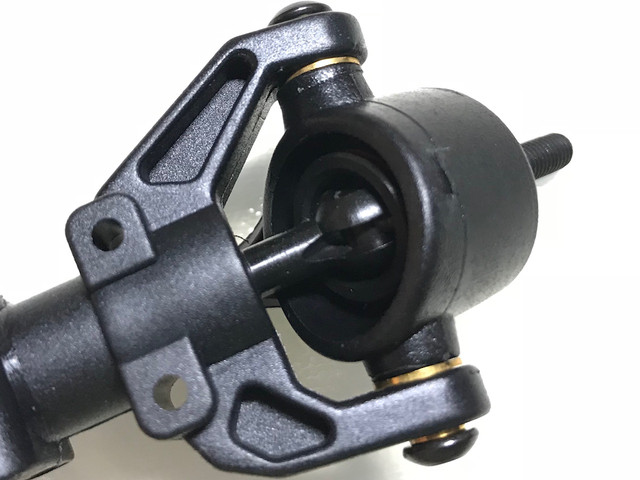

Others have done unboxings so I won't bother, but after sorting through all the parts, this is my favorite detail:
You see that? Metal knuckle bushings! They didn't have to do that, they could have went cheap and put plastic there like some other brands (*cough* Axial *cough cough*). It makes it seem like they actually care and I appreciate that, especially considering this isn't the most expensive version.

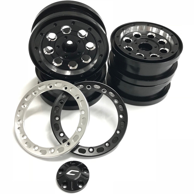

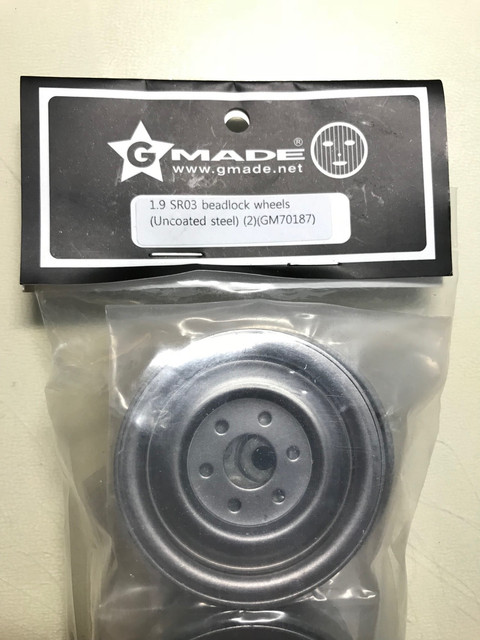

Next up are the wheels. They are nice... too nice for the worn-out junk this truck will be. ..
...THESE are much more like it. Uncoated steel, so hopefully I can grow some real rust here the old-fashioned way instead of painting it on like a chump. This will be one of the first steps of the build.

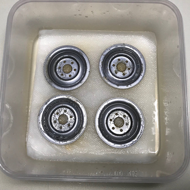

Getting down to business. Thinking back to the lessons I've learned by growing up in the Northeast, I know that salt + moisture = rust (whether you want it or not). So after doing approximately zero further research I gave the wheels a light sanding, covered them in salt, put in some wet paper towels and set the container out in the sun. (Only the faces of these wheels are steel, the rest is cast aluminum.)
After an hour we see some small progress, but I'm an impatient man. Youtube says try vinegar, so I try vinegar.

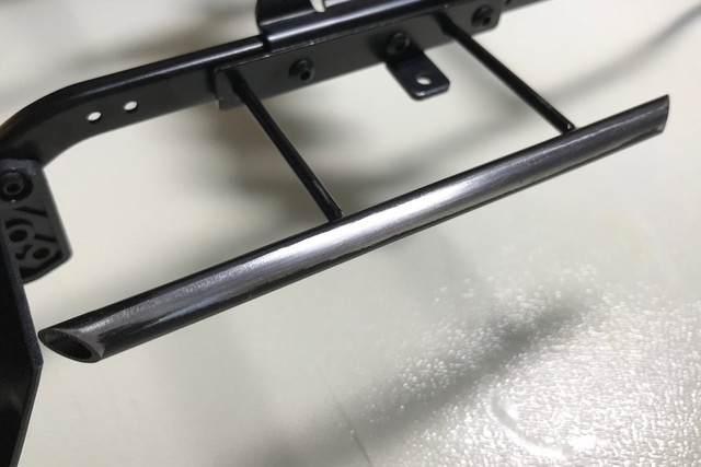

There we go! The vinegar did the trick. Feeling good about this result, I get cocky and decide to do the same to the bottom of the rock sliders. I prep them exactly the same way and...
...FAIL! This metal won't rust. I didn't think they were aluminum but maybe they are. Or stainless? I don't know. Will have to use fake rust instead later on. Me and my bruised ego continue on with the build.

TooOldForThis, will you seal the wheels with anything now or just leave them raw? Nice ride!
I was going to leave them raw, but they seemed a little too "orange" so I brushed a coat of watered down brown acrylic over them. I also painted the aluminum backsides of the wheels because they were looking WAY too nice by comparison. Here's the finished product. The backside is darker because brake dust. :mrgreen:

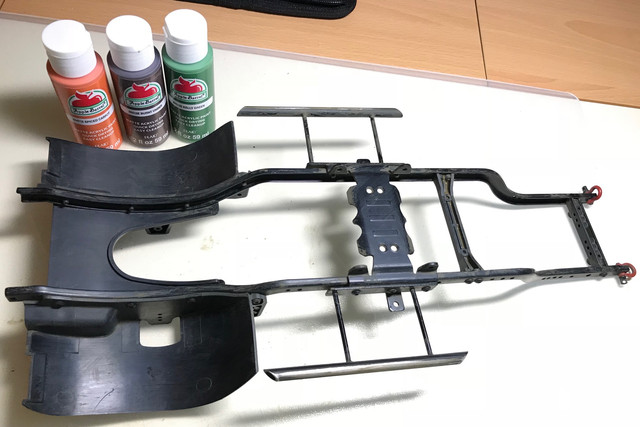

Moving on, you know what's embarrassing? Having a shiny new chassis poking out from under your ratty old body. To make sure that doesn't happen, I bought a whole bunch of these 50 cent acrylic paints from Walmart to make different dirt colors. Starting on the chassis now while there's still easy access.
The method I use is to mix the paint in a shot glass with water to thin it out, then brush it on thick, then wipe it off before it dries. It gets left behind in cracks and corners. The effect is similar to driving through muddy water, except you replace the fun of driving through muddy water with tedious paint work. :lmao:

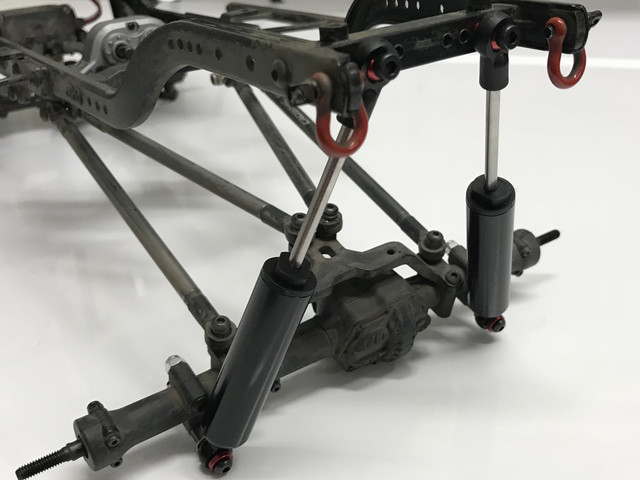

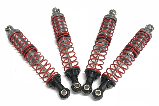

Taking a break from junkifying things, lets talk suspension. The stock 90mm shocks are nice to look at but I was never a fan of them on this truck. Something about the red springs, they just call too much attention to themselves.

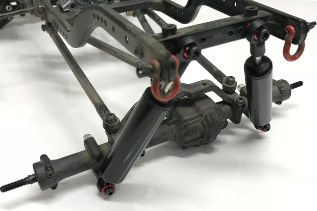

I replaced them with a set of 90mm Gmade G-transition shocks (GM20604). These are my first set of internal spring oil dampers, not to mention the first shocks with a specific "droop" configuration, so this was all new territory for me. Assembled for droop, they are 90mm from eyelet to eyelet (shown below), and you can see how much room for downtravel there is.
The shock body is a larger diameter than RC4WD-style pogo sticks, so we're turning down some more scale-appearing options in favor of articulation and smoothness. Speaking of articulation, here we are at ride height:
And here it is all the way down. The rear shocks drop out like this easily because I didn't install rebound springs in them. I think this could work well considering these trucks have a significant front weight bias... or maybe I'm wrong and it will flop around like a drunk cow.

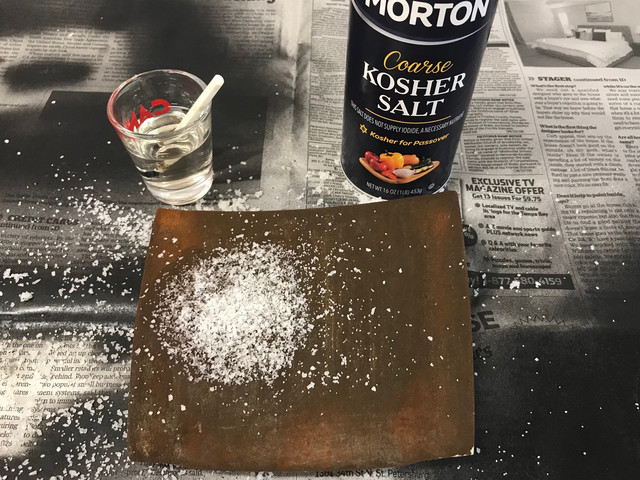

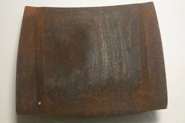

Next apply two-step rust and let sit overnight. This rust kit uses steel dust to create actual rust.
Now salt. Use a little water to get the salt to stick to the surface. Put a lot in the depression in the hood because that's where the "fire" burned off the most paint.
Paint black over everything, let dry, and brush off salt. Tada! Flat black paint probably would've been better than the satin black I had on hand, but we'll be able to reduce some of the gloss later on.

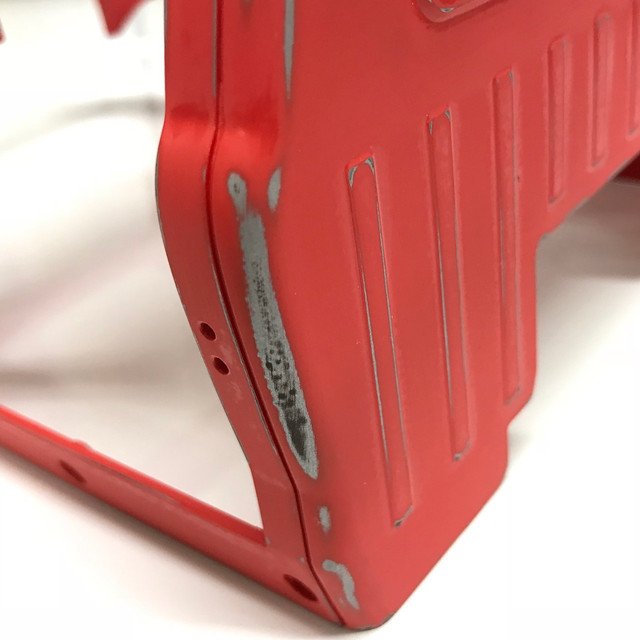

Lets ruin the cab!

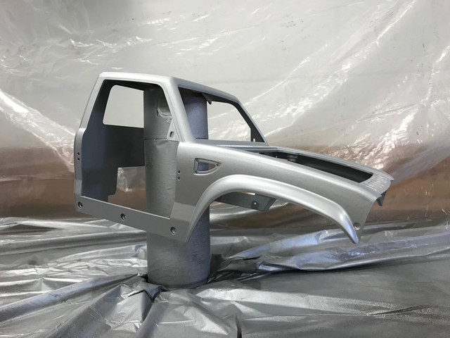

3 paint colors + sandpaper + love. First was brown around the bottom...
...followed by silver all over and a red top-coat. Similar to the hood in the last post, I sprinkled some salt before the top coat.
After the paint dries you get busy wet-sanding with 320 grit and rub off everything that's not a shitty old truck cab. :mrgreen: This was a fun process. I did the same thing to the front bumper and grill, except with black over silver.
Great job all. I like the gmade shocks look more nicer than the stock shocks. The upside down placement looks amazing real one. Just wonder how this shock performance. Update us how the articulation compare to the stock. "thumbsup"

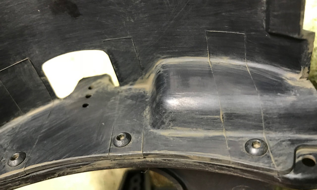

Nice! Are you going to drill and file some holes in those fender flares and cab corners?
I'm not OP but when you do holes through the paint and bad rust spots and holes you need to do it before you do any paint. If you drill the holes after paint you see the color of the plastic. I did basically the same thing on my Hilux body.
I was thinking if you painted, then drill holes and touched up with a brush it would add even more texture any excess on the edges would add to the effect. But I see what you are saying if you don't want to follow up with a brush.

Thanks. Its gonna be awhile before I can really test it but the main difference is the gmade shocks give you a lot more downtravel (but less uptravel) than the stock shocks. I guess that could be good or bad depending on how you wanted to set it up.
