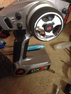

DX3E transmitter and SR301 RX

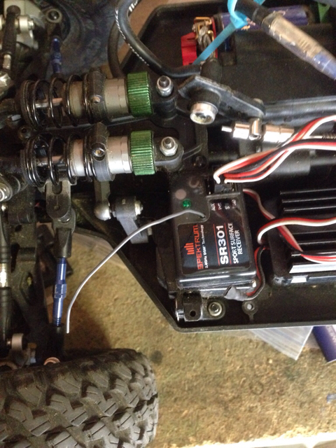

They bind and work, but looks like previous guy cut antennae and I get about 15ft of range. :(
I tried to bind with my DX4C tax and it just won't. I researched and perhaps these are incomparable.

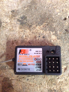

So, I try to make use of a Fly Sky Fs-gr3e that I have. Brand new. Neither receiver will bind with it. Ugh.

Unless you get lucky and get a early DX4C they are not backwards compatible and can only bind to DSMR receivers. I'd personally just sell the DX3 and the Flysky and buy another receiver with the money and run everything off one controller since it has 10 model memory and enough options to do whatever you would need.
