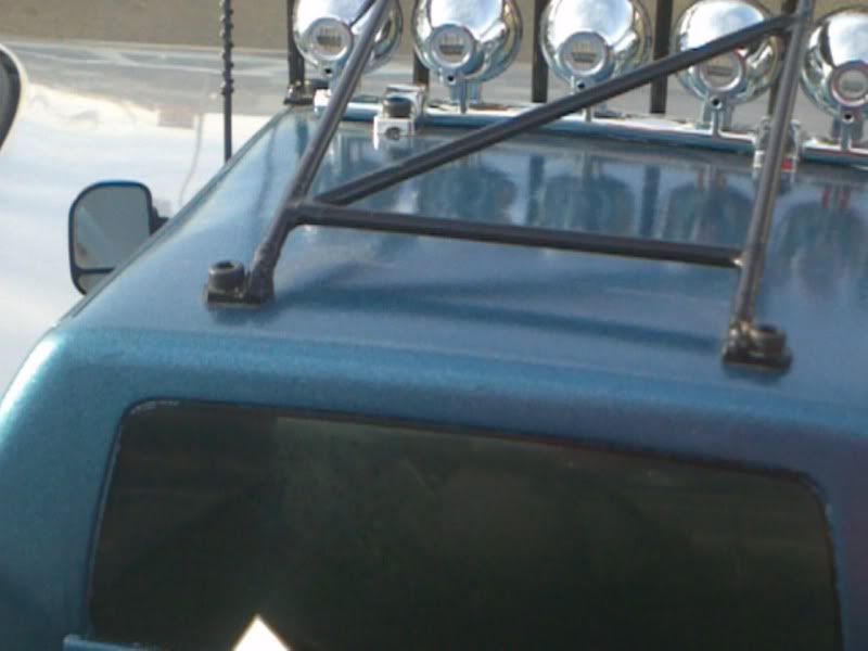

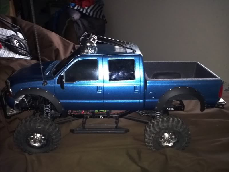

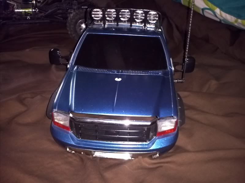

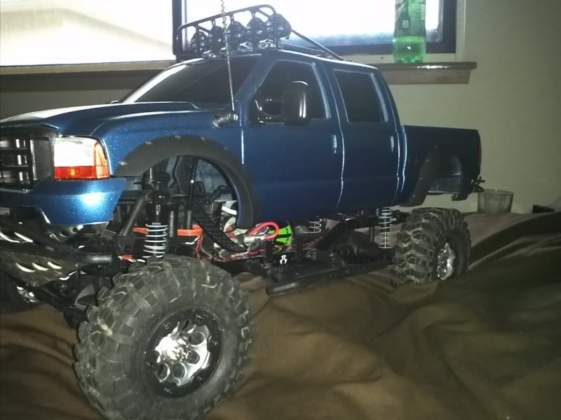

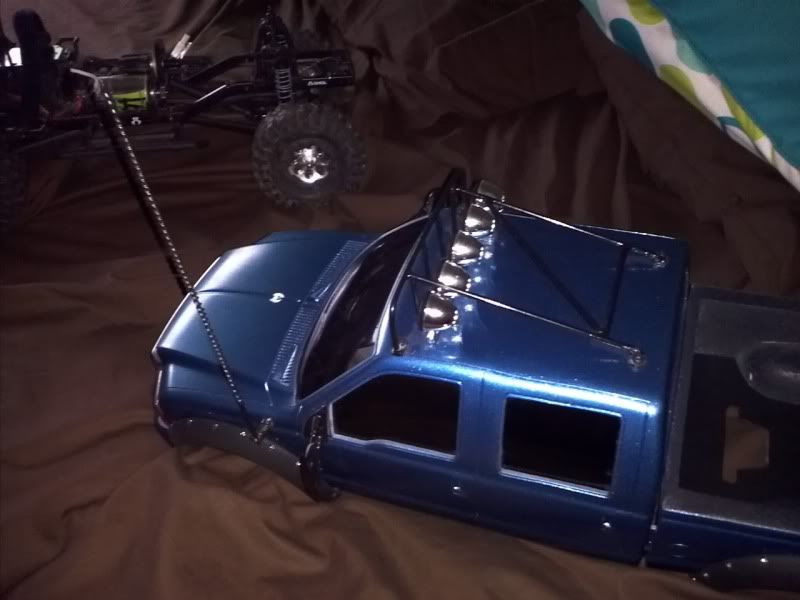

Hi everyone been working on my new build, I'm taking a stock RTR Honcho and adding my Tamiya F350 all custom built extended Crew Cab. I'll have more pics soon. Parts I have on order are K & S aluminum tubing (stock# 3031), some 8-32
all thread and some Traxxas Rod ends part# 5347 and some extra Axial Drive Shafts. I need to lengthen my wheelbase by about 2 1/2" to fit the body as seen in these pics.
Killer looking ford!! Should look good when you extend the wb and maybe lower it. Looks good man!!

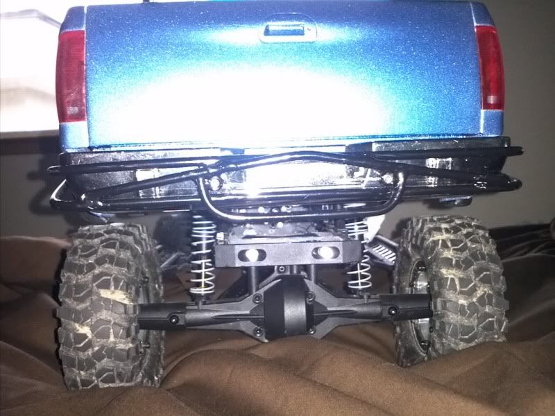

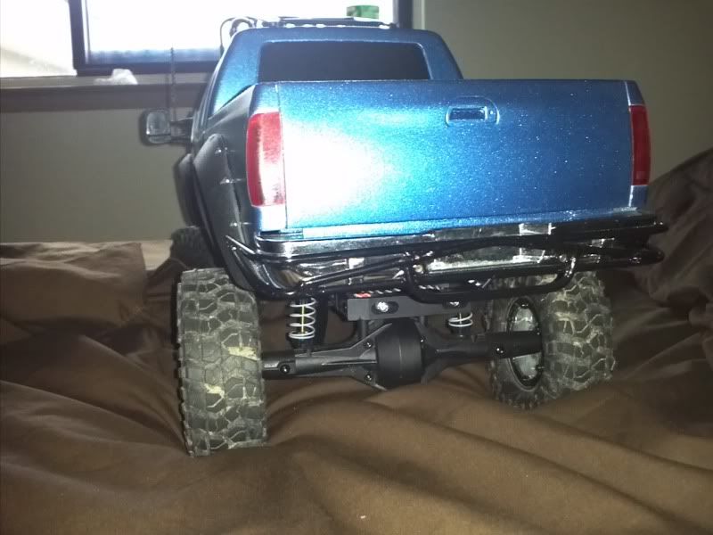

Body looks good! I'd drop it and yes extend the chassis rails after the bend at the back. The rear bumper looks good! Did you make that? If you haven't seen my big Ford, check my signature. Pm with any questions. "thumbsup"
Thanks yes I plan on dropping it extending the chassis and making my own custom links. What shafts do you use BTW I like the chrome look and I'll defently need an extended rear drive shaft for my rig when I get too the modding of it all. I wish I could take credit for the tube work but no, a local gentelman has a huge part of it. I met him throught my place of work. He does really good work.
