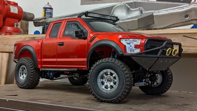

I'll give it a go at helping you out. I more or less went off the deep end with my Element SCX-IFS prerunner but there are ways to bolt parts together and make things work. Just got to get a little creative.
Take your 10.2 and strip it down to the bare chassis. Mount the IFS with the 3d printed plate along with front shocks and wheels tires if you can. Since the IFS is fixed in place you'll want your body placement to be based on the front end.
Next you will want to mount your body, be it with screws or posts/body clips, etc.
Now take your back axle, remove all links, bolt up wheels and tires and flip your chassis and mounted body upside down. Take your rear axle assembly just lay it in where your fender wells are. This is for a truck type body where at full suspension bottom out, the axle is centered in the wheel wells. Now you can measure how long of a trailing arm you will need to make up the wheelbase you need. This is the tricky part as sort of pre-made trailing arms (like off other kits) are either too short or two long. You can get creative and make some sort of mount on the chassis to make a Yeti trailing arm work with your wheelbase, but shock location is also a consideration. You should also consider mounting trailing arms outside of the chassis.
Now there are ways to kind of make things work, but I spend a lot of time around full size desert trucks and would rather point you in the direction of making one that is similar from a functionality standpoint. I wish there was an easy answer or maybe a full "prerunner 10.2 conversion kit in a box" but until then, enjoy the challenge. Whatever you come up with, you'll learn a lot and will certainly make changes down the road.
Here's my build thread you might be able to use for reference. Page two is when I started using the Element IFS. Also don't be afraid to look at pics of 1:1 prerunners and desert trucks also. Those are almost more helpful than looking at pics of RCs.
