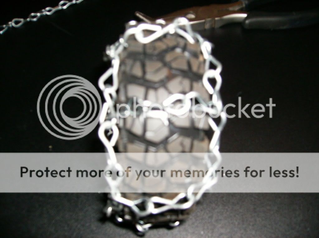

I got my snow chains ready. 10 Rows per tire. SWEEEEEEET!!!!
I experimented with different type of links as well as link count.
It took several attempts to make a set that would clear the steering linkages but would not come off the tire.
I also had to keep in mind to link direction.
I purchase the link chain at home depot. The links were small enough but very strong. It required two good pliers to remove some the links and get the proper length.

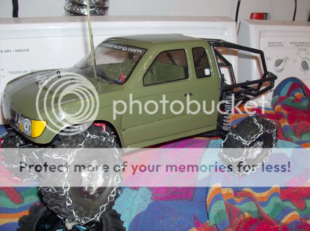

i got me some of them. i bought like 20ft of #16 jack chain and spent the afternoon making these.. i used like 17-18ft to make these.. they are for my 1.9's but im running 2.2's right now. was gonna toss the chains on run the 1.9's in the winter but i have another trailer build planned for them.
here is a few pics.
yeah i hear you on that!!! first tire chain took me like 2hrs. then i finally got the assembly and mounting down to 45mins a tire. had to use 2 pairs of pliers to unhook the link.
