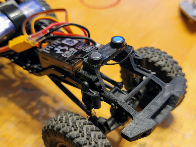

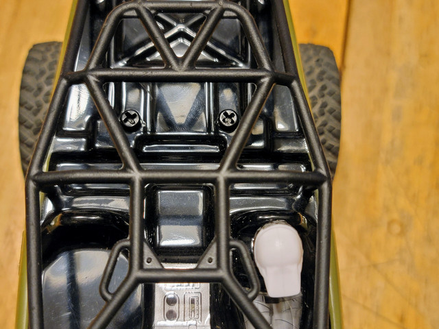

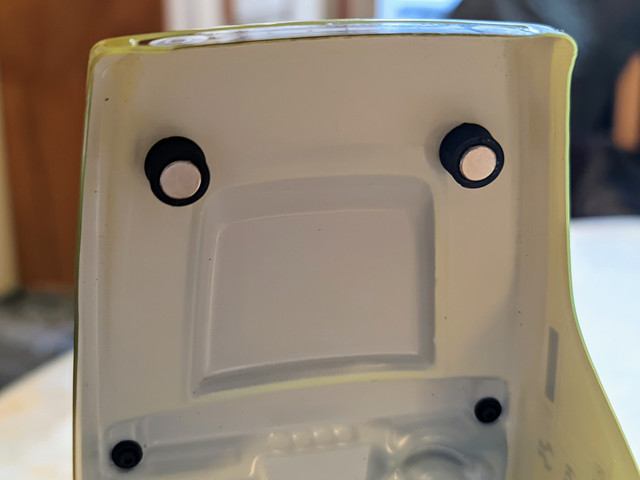

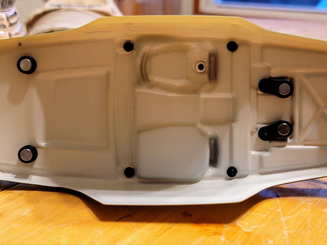

Rather than use the stock body posts and pins i drew up and print some mounts that use 6mm neodymium magnets and M3 nylon screws to hold the mounts in place. They're working out great so far.

Yes, I just finished making a setup to work with a rear shock tower/bumper that i print (not my design) then I'll make something to replace the stock hinge. The rear mounts on the body are the arms to keep the height shorter.
