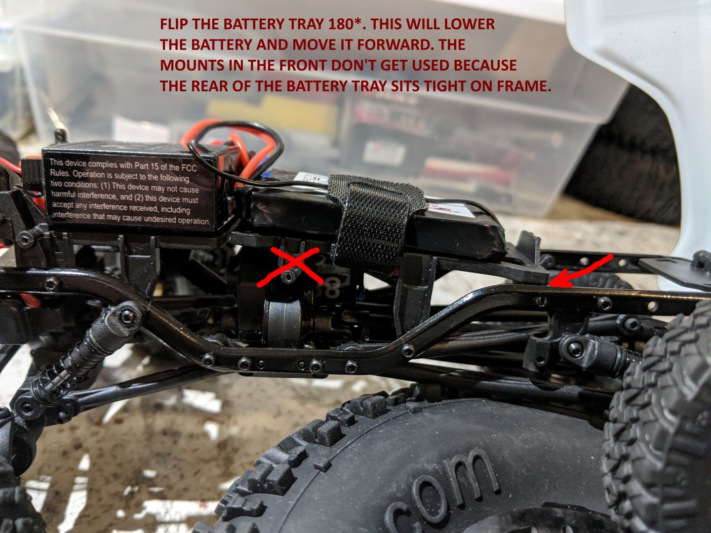

3. I spun the battery tray 180* and this allows the battery to sit lower and forward more.

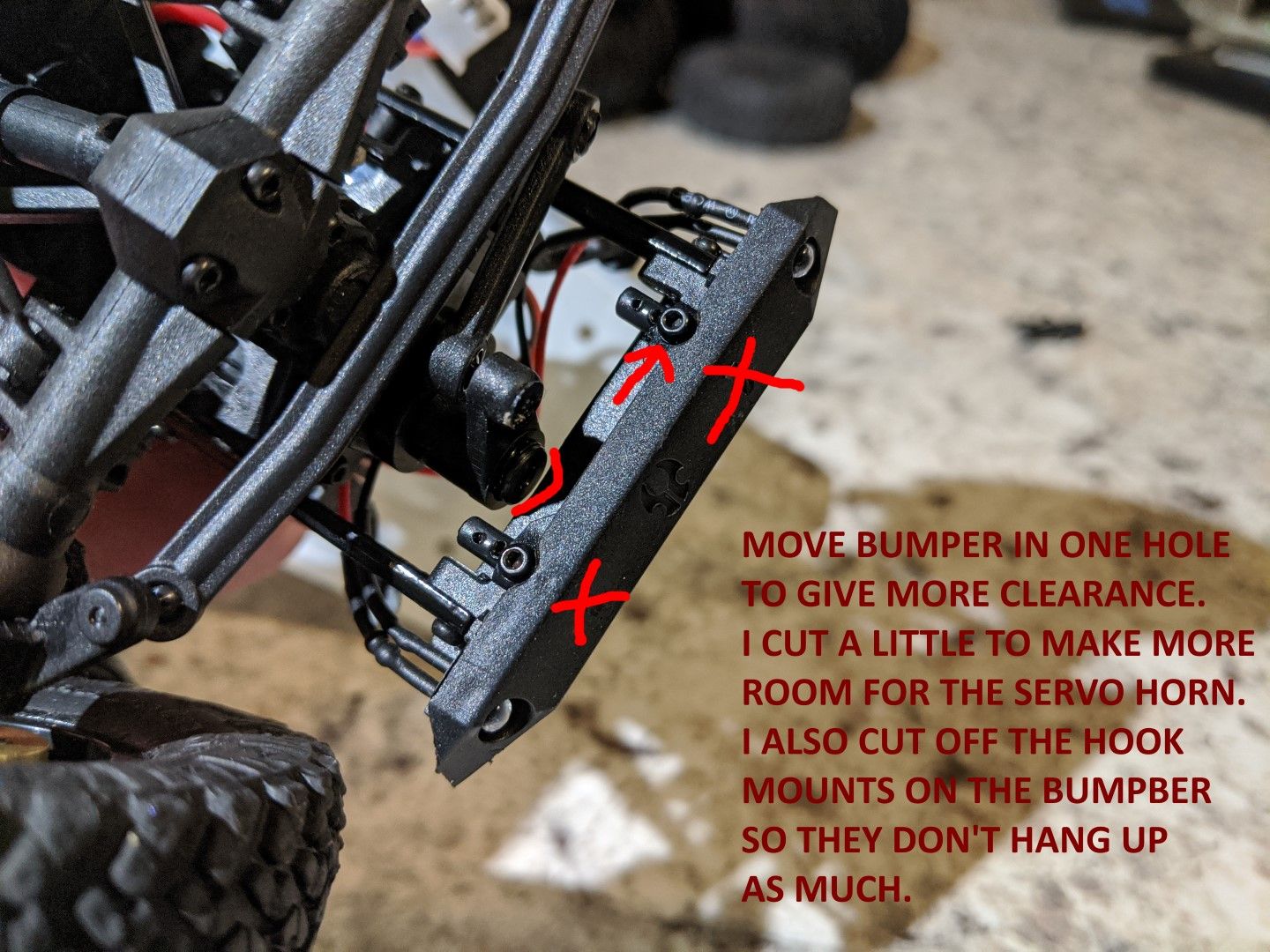

4. I pushed the front bumper in one hole and clearanced for the servo horn to give a better approach angle.
