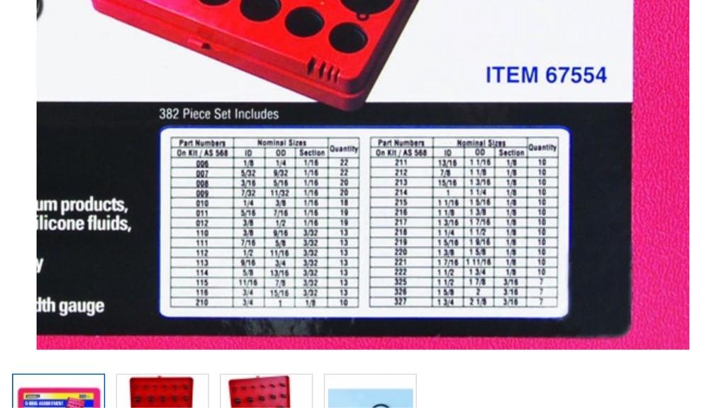

Harbor Freight?
Ive tried looking everywhere for them too, i just bought some cheap front links, came with some, and also the upgraded aluminum control arms, suspension arms? It’s not the cheapest way to get them but... hey. 30 bucks for 22orings ehh
