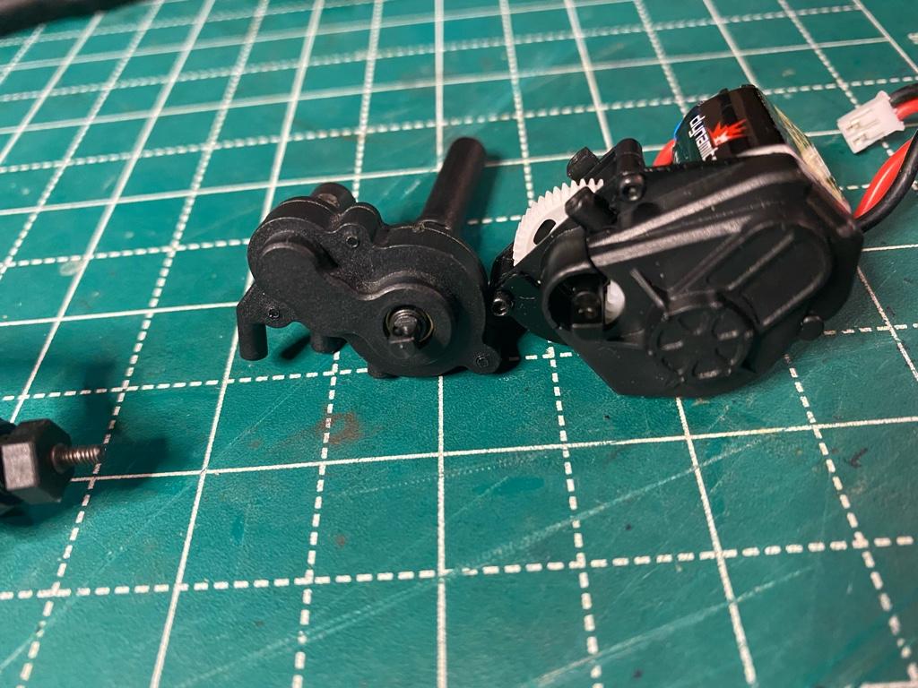

Found one of the quirks tonight. I was hoping to use SCX24 driveshafts. The E24 transfer case’s outputs a bit bigger than the SCX24. The pins holes for the coupler was smaller on the E24. Also, found the weakness of the E24, the axle joint. Snapped a pin while making driveshafts.

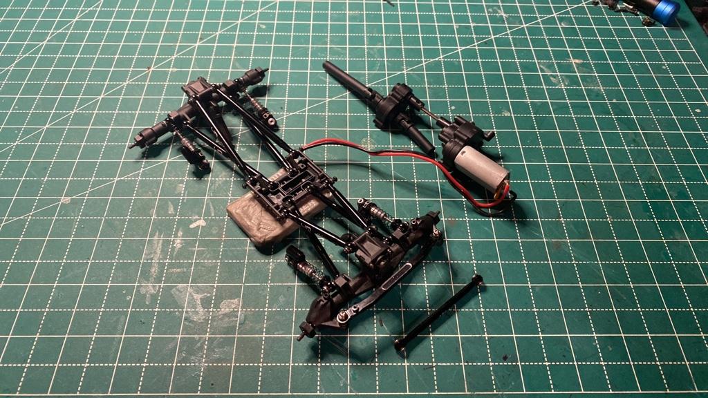

Well work has been started on the SCXE24 Sonoma tonight. I removed the drivetrain from the Enduro24. And then removed the lower half of the Deadbolt. Turns out this little guy will have a lot of SCX24 DNA when done [emoji33].

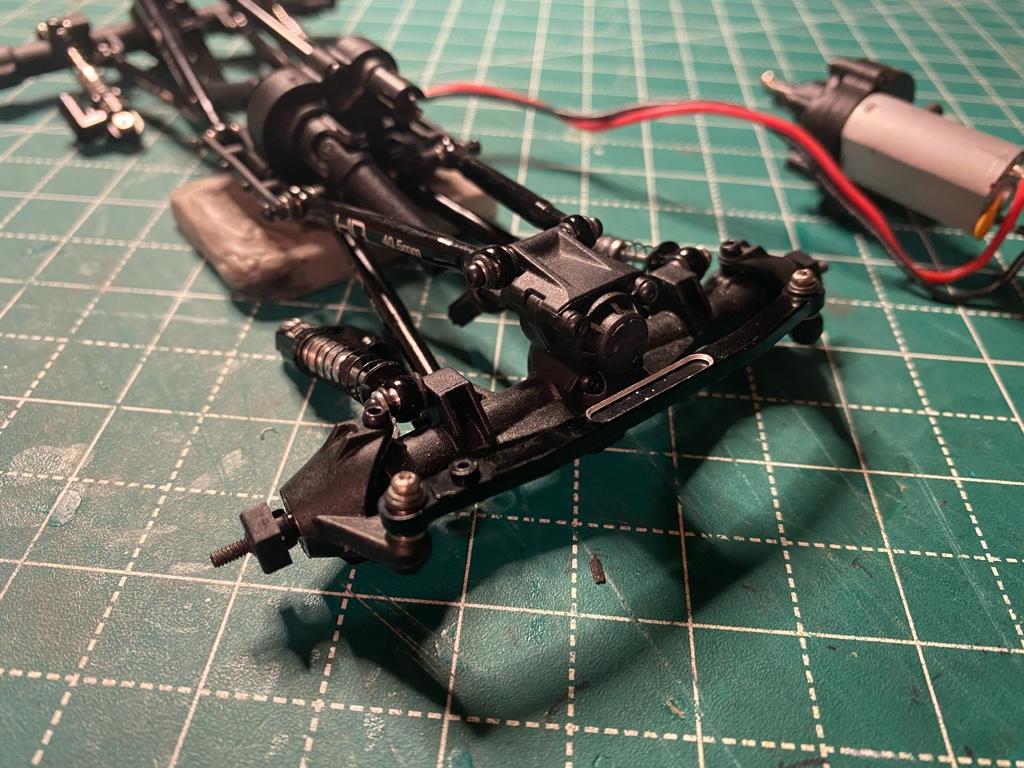

I ended up removing the axle based steering mount and replaced it with a rear link mount. I am planning on a chassis mounted servo.
Well that caused the first change. I ended up lengthening the front end. It is now at JLU/C10 with Deadbolt rear. The mount also forced a 4 link front.
Then it was time build the driveshafts. First found out the transfer case has bigger output than the SCX24.
Well first, I tried to put a SCX24 shaft on the E24 yoke. Heard a snap, the joint pin snapped off. Then attempted to use SCX24 joints, and the pin hole needed to be enlarged. A 1/16 bit did the trick nicely.

A question for the community: 3 Link w/ Pan Hard or 4 Link? I’ll be using a chassis mounted servo on the build. The motor will be mounted next the servo on this setup. Which setup is better in this case?
One thing I didn’t particularly like about the CMS of the Enduro24 was that sometimes trying to turn the wheels on a hill would upset the chassis and make it fall, I would try a pan hard to prevent that. I ended up swapping my enduro24 axles for scx24 ones for the steering and gearing benefits. Had to make custom links to fix the geometry though.
