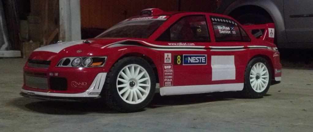

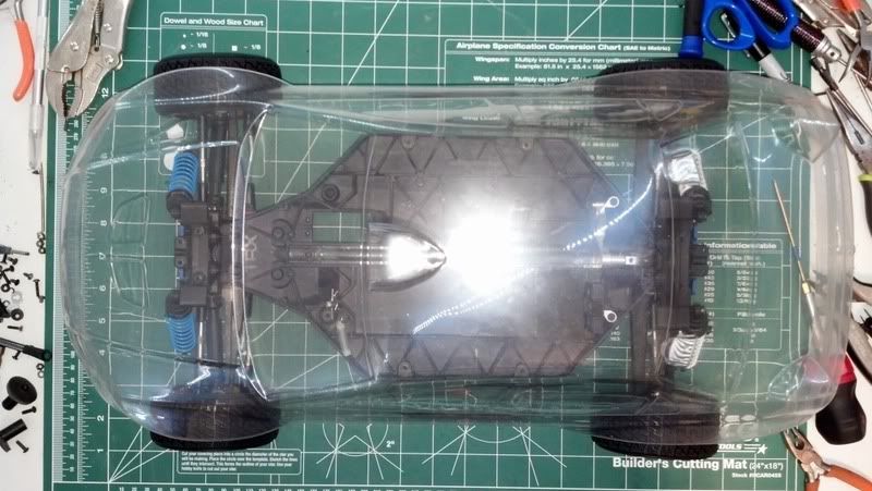

The build started as a box of parts for a slash 4x4. Much like Traxxas I find a lot of things I can make out of one platform. I really don't think there isn't a type of vehicle I haven't made one into. I bought the Kyosho DRX clear mitsu body and a set of Kyosho wheels and tires and bolted them on. Trouble was the DRX body is obviously not as wide as the slash. This is what I ended up with picture below.

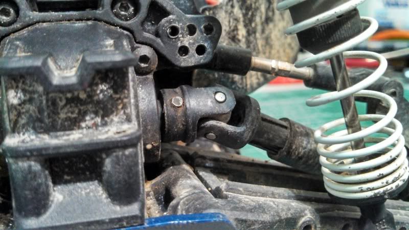

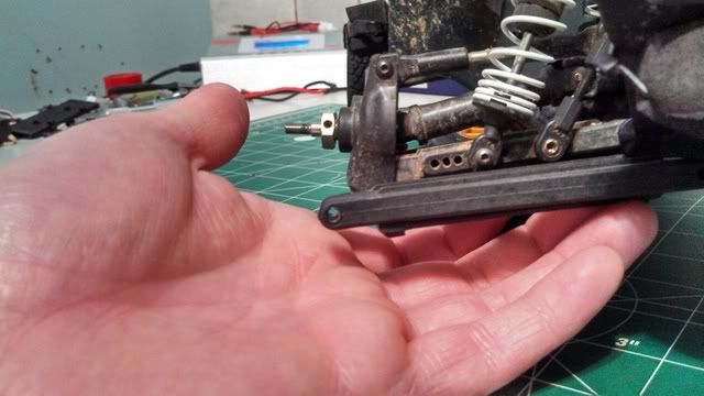

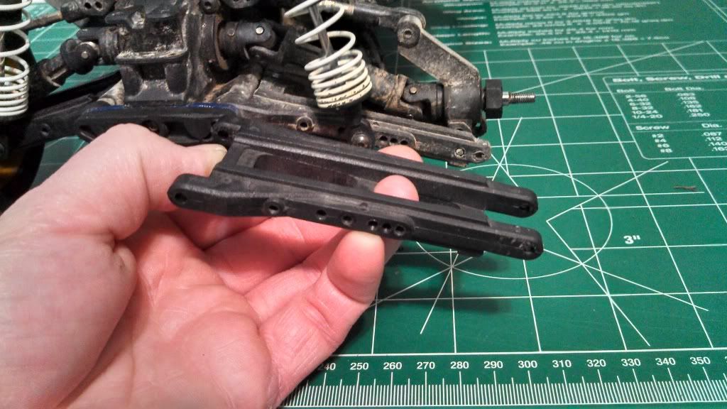

First I eye balled how much to cut off the rear A-arm and ground it down to my desired length and got out my trusty drill and drilled an new hole for the rear hub carrier pin. Since I really wasn't going to be showing this off (I guess until now) I didn't make everything look all pretty my main concern was functionality. below is a comparison of a stock A-arm and the shortened one that I made. Sorry I don't have a measurement of how much I cut off. Honestly it's all in what you are putting on for wheels. Mine are a little shorter so that if I change a body or wheels I can use different hex hubs to adjust the wheels backspacing.
Then came the axles

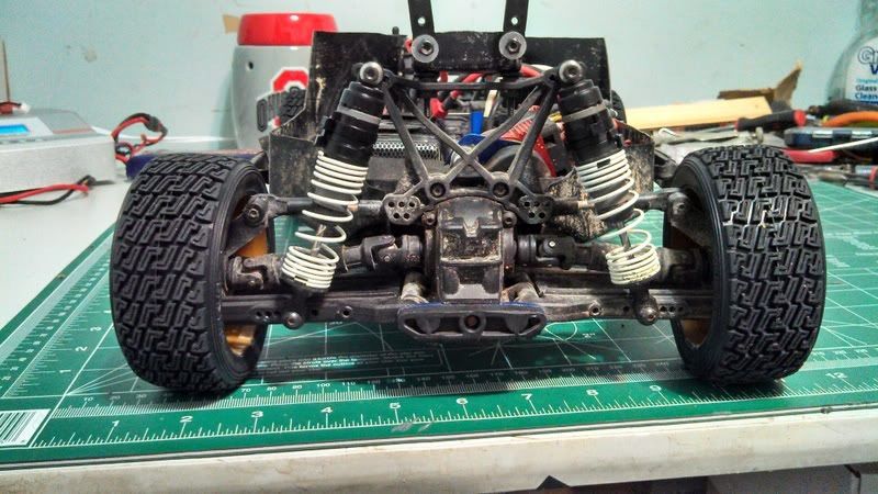

Here is a pic of the rear completed. For the links I just cut down the rears a little so that I could turn them in far enough. On the fronts I was able to just turn them in and not have to cut anything.
Same thing in the front. Cut the A-arms once I got my desired length I cut the axles. The front didn't require me to cut the links I was able to jsut turn them in. You do need to grind or cut off the top mounting hole on the c hub though to clear the wheel.

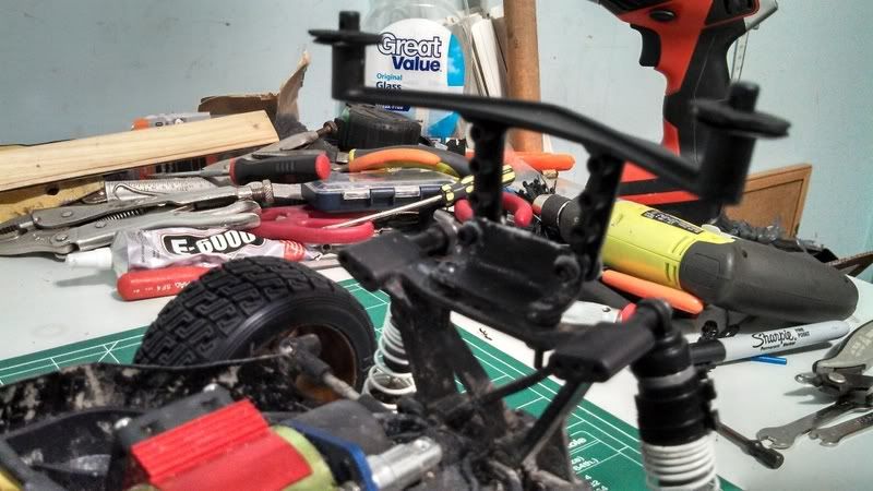

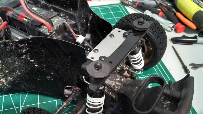

Next came the body posts. These in the pics are actually for the new body I just got and not the original mitsu body. The concept is still the same. For the front I used an aluminum servo plate I had made for a scx10 project and and a traxxas body post mount from a slash 2wd i think. The body posts were ground down to near flush and then screwed to the body post. I am a huge believer that if you buy a RTR painted body then you need to make new body posts to line up if your stock ones don't. I can't stand seeing extra holes in a body.
The rear body posts were from the same traxxas body post package. To get the height I needed I used a small piece of aluminum and bent it to a 90 degree angle (sorta I basically used a pair of pliers and prayed that it was good enough when I was done..lol). Yes they aren't the sturdiest but I am actually going to make new ones out of xo-1 or summit body posts. Something a lot stronger.

So here is what she looked like with the original body.

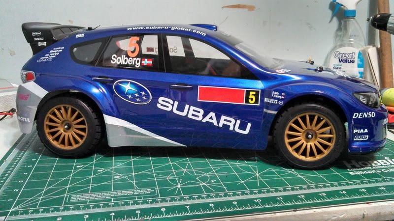

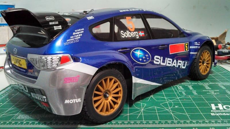

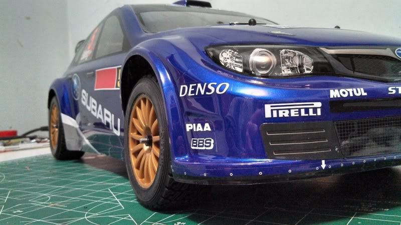

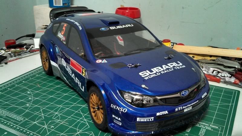

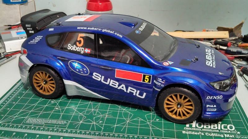

And here is what she looks like now with the new body and wheels.
