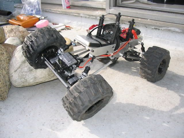

Here's a "stocker" for ya:
Stock TLT chassis/tranny, albeit heavily modified. This is a droop set up, basically just trying everything possible to lower the COG. Tranny is modified with a homebuilt tensioner and a thicker/wider belt out of an HPI Nitro RS4.
poser shot:
Axles are locked via the jammed spider gear method, tranny is locked with JB. Currently running a Integy 55t w/ Rooster Crawler and 2 Towerpro MG945's, controlled by a TQ3. Body is an HPI MX-1...
