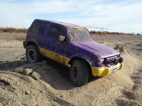

as it sits currently. not much but it has always been fun to drive on the few chances i have had.(hopefully to change that soon!)
