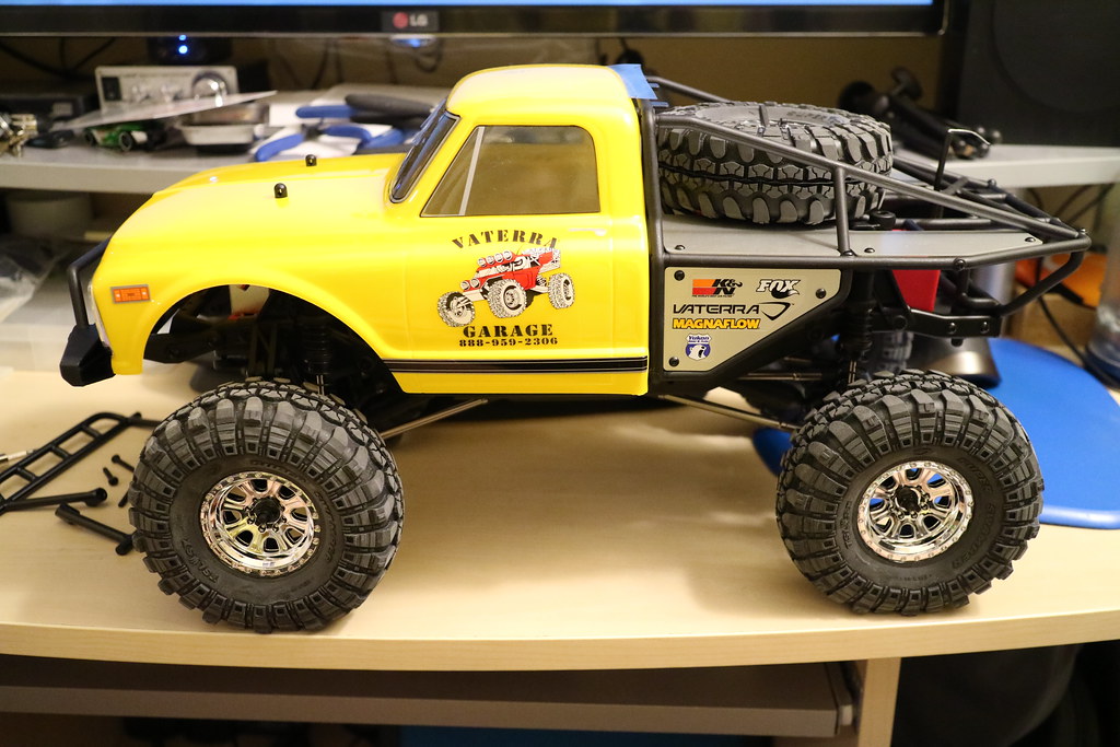

Here's how the truck looked when I first got it. So clean and fresh :lol:

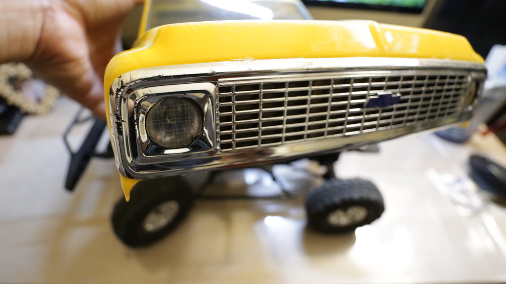

I've been wanting to add headlights to this truck for a while and finally got around to ordering the parts.

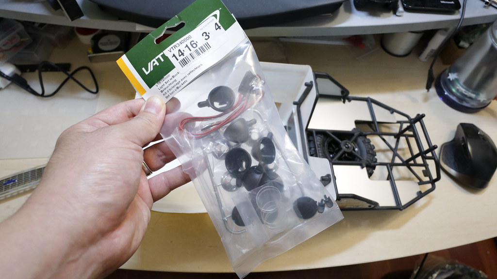

I used the Vaterra Light Set with Buckets for the Headlights.

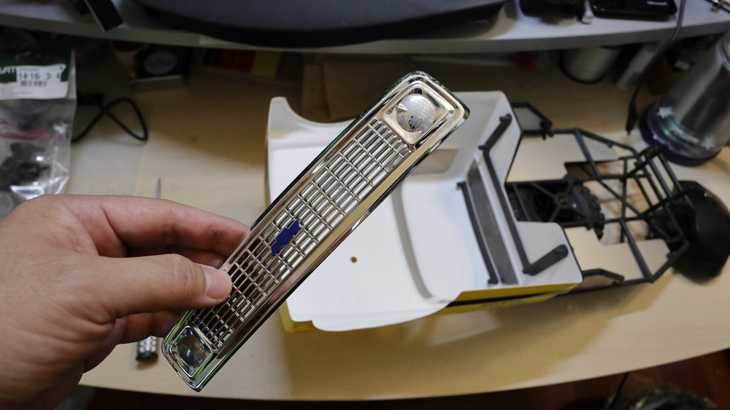

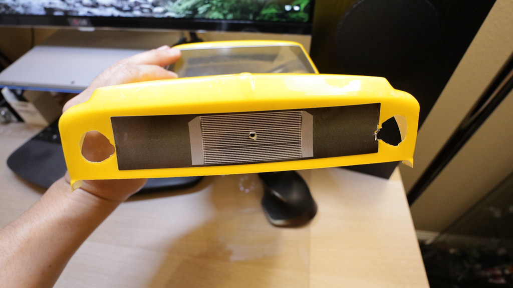

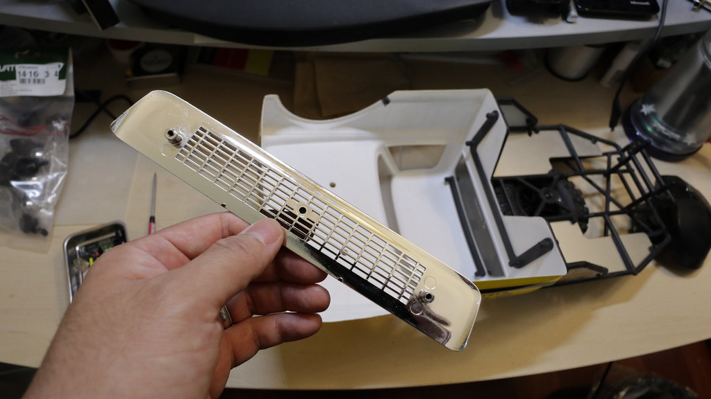

Removed the grill from the body.

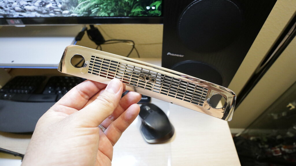

Took a dremel and dremeled out the headlight area in the grill
Made the necessary cutout in the body for the headlights

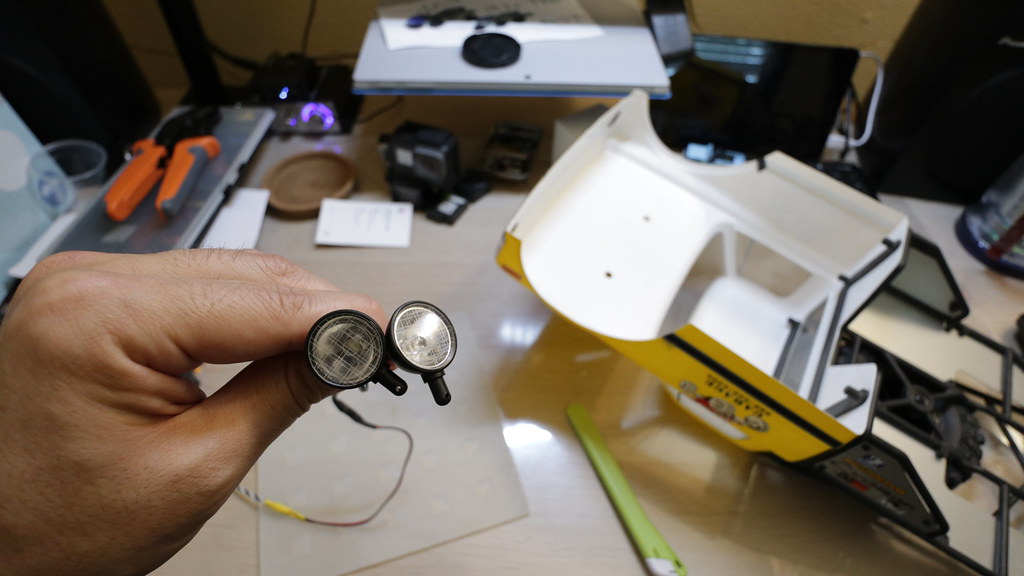

Took an exacto knife and scored lines into the lenses from the light bucket kit.
Adding the LEDs
This is what they look like when the assembly is put together

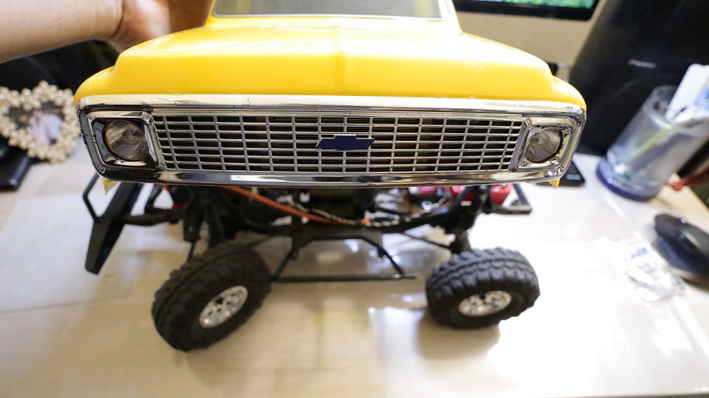

I used the almighty Shoe Goo for gluing the grill and light buckets to the body.
Shoe goo'ed the grill onto the body, and then Shoe goo'ed the light buckets to the inside of the body.
Here's what they look like fully attached.

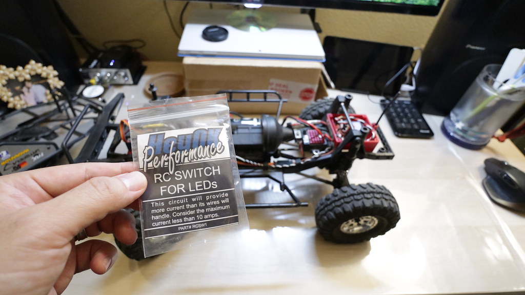

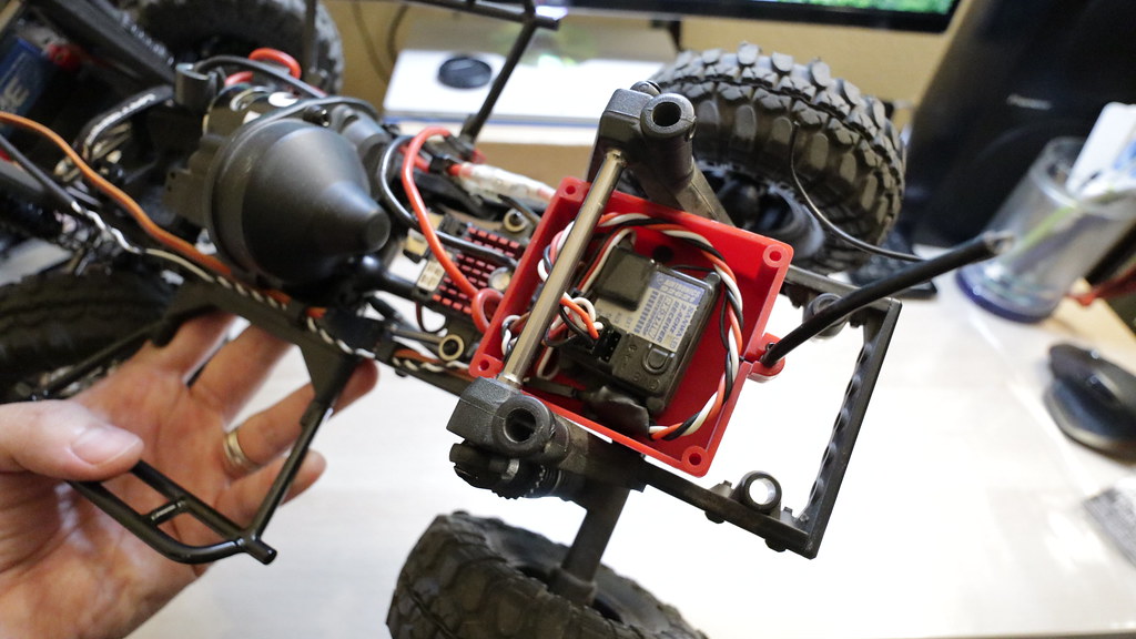

I also used the HeyOK Performance RC Switch for LEDs
LED Switch tucked away in the receiver box
Routed the LED wire along the same path as the servo wire
Let there be light!
I'm shocked that you had to cutout the headlights in the chrome grille. It was worth the effort though.
Nothing can be left alone! :)
Lights look good. What Dremel bit did you use to open the headlight openings in the grill? Looks really clean.
I actually used a reamer first to ream out a good sized hole for the bit. Then I took a dremel with one of the sanding bits to grind away and round the rest of it out.
Seriously, Between the K10 grill and the F100 grill.... the F100 already has the headlight cutouts and uses lenses. The K10 cheaps out and just uses stickers over molded headlights.
I guess this was Vaterra's Deadbolt then. If not drilling holes in the front is as cheap as they get them I'm OK with it. Not like Axial where the base model gets cheap everything.

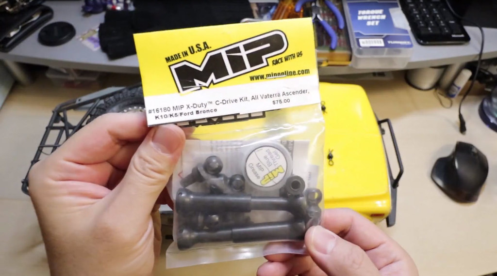

Those weren't really $75, were they?
LOL no. There is no way I'd pay that much. In fact I'm probably sticking with stock for my own, or getting the GPM driveshafts.
Only reason I got these was because my son somehow always gets sand in the stock driveshaft where we crawl. When he does that, the stock driveshaft "sticks".

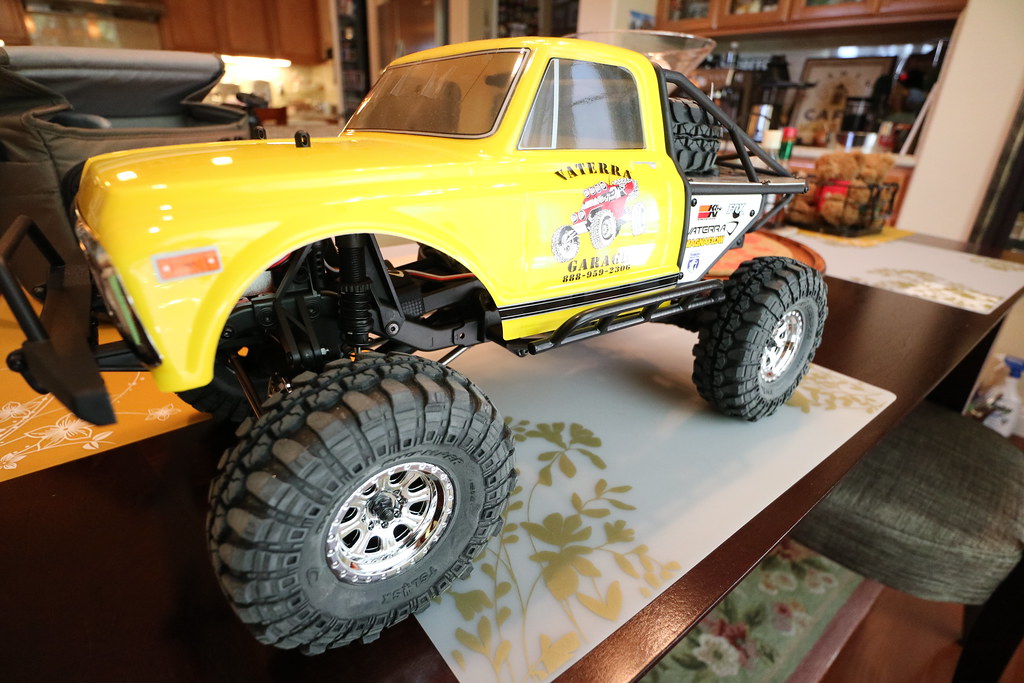

Well, my son has been beating the K10 for a while now. It's perfect for him really, since the truck is really durable.
Today we headed out to CDM rocks where I met up with Browneye and a couple of his friends (Oscar & Bill). Really cool guys. I hope I can make it out there more often and crawl with them. There were 2 other guys running 2.2 rigs (Wraith & Bomber) out there that were pretty cool too, though I don't know if they're on the forum.

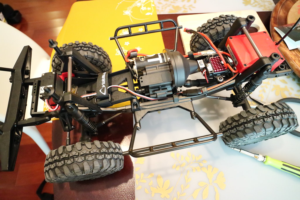

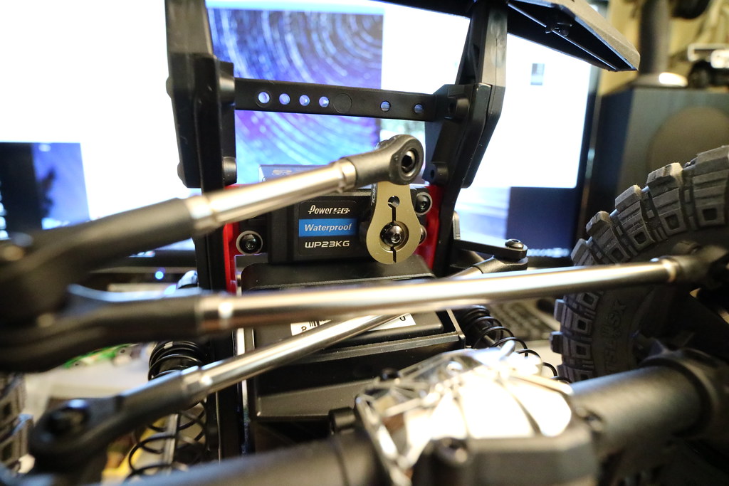

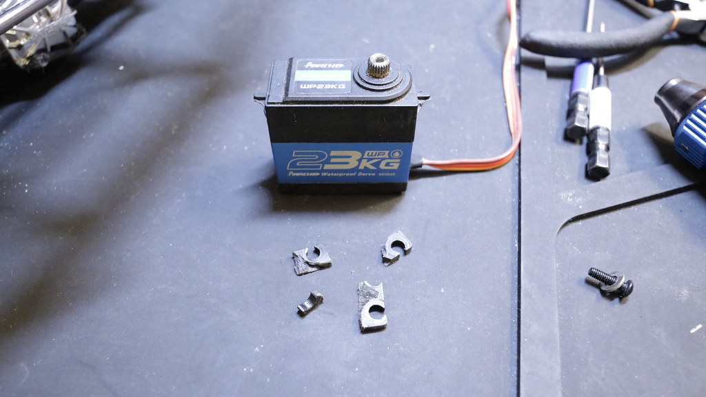

Anyway this is the first significant carnage my son has caused on his Ascender. The Ascender survived, but the servo didn't. Really odd way to break really. I don't even know how he managed to do it.
Watching my son crawl at this place showed me that I still have a bit more tinkering to do on this truck. He's at the stock K10 wheelbase, and I think he'd be better off running WB3. He was definitely flipping backwards on inclines though it was also partly due to his "enthusiastic" throttle when frustrated. When he was using proper throttle control though, he still was experiencing short wheelbase limitations.
I'm also going to take out the 27t brushed motor and put in something slower. I let him drive my GMADE BOM for a bit, and he liked the slower speed (I'm running a 550 35T brushed motor). I've been hesitant to put too much money into his truck, because I didn't know how it would handle his beating. Now that I can see he enjoys trying out some of the challenges at CDM rocks, I'll probably start adding a little bit of stuff to his truck to help its performance.
Nice job on the headlights, really bright and the HeyOK switch to operate them is a nice touch! :)
Ouch on the servo broken, one more reason I tend to avoid the cheaper servos, I've not had good luck with the gears in them either. Always use some hold down clamps too like these,
https://www.fullforcerc.com/FF023
What's your replacement servo setup?
I just had a $10 20kg special on hand so I used that.

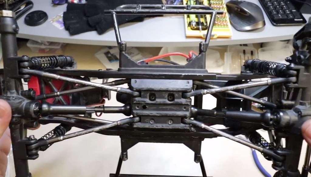

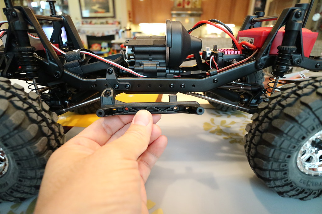

I've just extended his wheelbase by adding spacers to the rear links without extending the chassis, so he's at around WB3 length now I think?
Also added SSD weights to his truck. And plan to get him a swaybar. Next up are beadlocks and tires/foams for him.
I'll try to post up pictures when I get the chance.

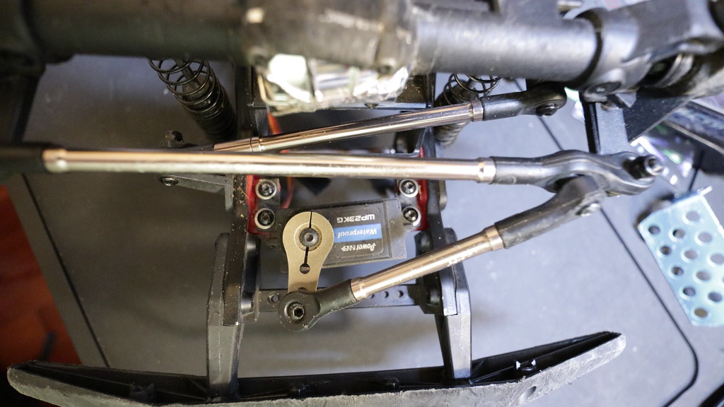

I also want to change his servo orientation to the WB4 orientation if possible. I don't know why I never noticed, but the way the servo is mounted now, the draglink is out forward like the Gen8, but not as bad. I also noticed with the truck that it has more throw in one direction vs the other, because at a certain point the servo horn becomes parallel with the axle and can't really move on one of the directions. I'm guessing the servo relocation will help with that if the servo horn is dragging that link from a different spot.
Cool. Servo, switch to other orientation if needed, but servo horn needs moved 1-2 teeth and then re-centered to get equal throw in both directions.
