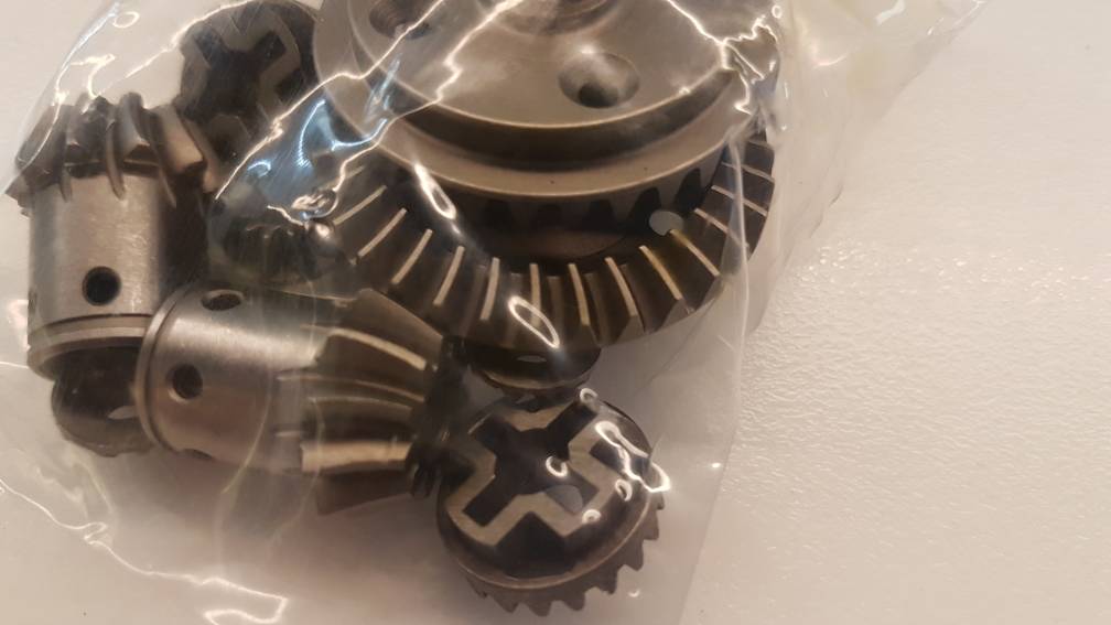

Got my kit... Just going through all the parts and my kit came with the bevel cut gears
Is this normal because it's not advertised to on the box or the website.
Now I'm happy and not happy at the same time because I do not have the means to cut the lip off (BHB mod) and I hear this MUST be done on these gears for propper mesh...
What can I do??

Just do the three bearing mod. You don't need to remove the lip, just need some extra shims
I am actually reading the 3 bearing mod thread now.
I don't understand how it will do anything other then have an extra bearing as a failsafe.
Even with proper shimming isn't the pinion at the same dispance due to the last bearing and 3 screws always at the same place?
The only way to move the pinion away from the spur would be to grind them down a little?
It's my brain figuring it out.. I'm an IT engineer not a metal one :-)
EDIT: I UNDERSTAND NOW!!! So by having LESS shims and the 3rd bearing the whole thing is slightly shorter. So that means the shaft/pinion "floats" in the diff housing. So when the 3 screws are tightened down there is a small gap between the screws and bearing allow the pinion/shaft to move freely and "settle" in the ideal spot for a good mesh. That is a great compromise becasue even if it floats towards the pinion when it spins it will still settle in the sweet spot.

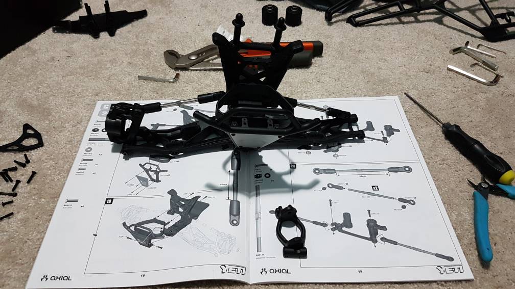

I have started putting my kit together tonight (still waiting on bearings so skipping drivetrain steps for now) and they bloody sent me 2 RIGHT HUB CARRIERS!!!
For crying out loud! If the local hobby shop doesn't have stock then I'm not going to be able to use by the weekend.
I asked when I got the kit "if any parts missing etc do I contact you or axial" and they said they will sort me out so I hope they have stock.

Double damnit Axial!!
I'm also missing the 4th spring retainer!!!

Little update.. have gotten this far (munis the drivetrain.. waiting for bearings) and it's all going together well.
The LHS was able to provide me with the missing parts no questions asked so very happy with them :-)

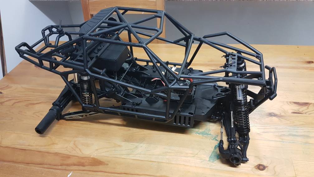

Did a little more work on it today at my desk at work.
I have to say.. axial *sigh* all 4 of the rear links were different lengths.
The 2 uppers were about 5mm different and same with the lowers, I had to make the holes bigger to get the screws in.
Completed the "build".
I still have to do the entire drivetrain as my bearings did not arrive today but 100% tomorrow.
Overall it seems like a solid build (yes I know im late to the party and you all know the weak points etc.) and I'm really excited to take it for a drive.
Note: heaps anoyed that my 3s lipos do not fit but like 2mm.. what do other people do??
