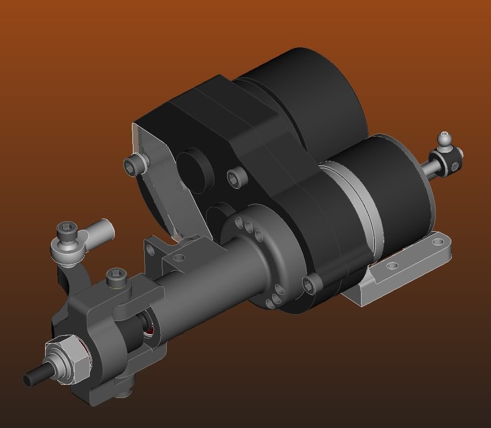

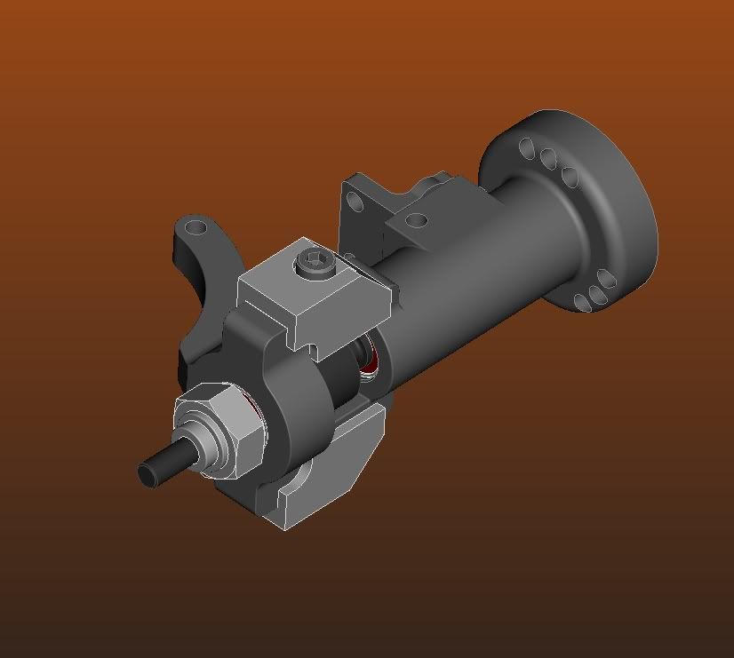

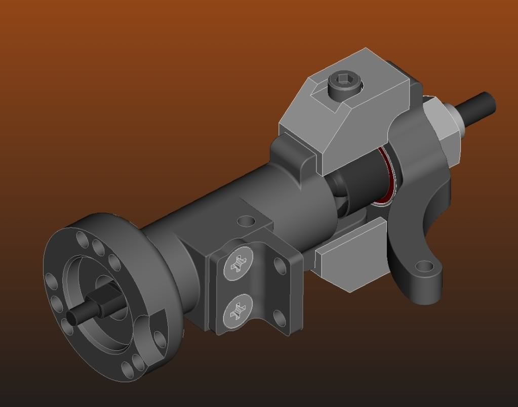

I have an idea for a steering lock-out on my Berg axle. Check out the pics. and let me know what you think. They would be simple to install.
I also noticed the N.A. Berg axle shares a lot of parts with the HR axles / tranny. Here is the Berg tube on the HR tranny :mrgreen:.
I'm sure someone has figured that out before I did. Just noticed it today myself.

A clever idea, the only thing I don't like is the slightly reduced clearance and the minimal material to hold the load. Test, and make sure tolerances are tight.
Thanks for the input. I have looked around and havn't seen anything else like these. I planed on making them out of steel. should be plenty of material to handle the loading. Plus the steel will add a little bit of weight.
