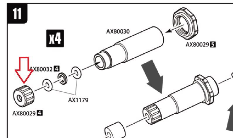

alright. take your shocks apart. take the orings out of the cap. fill the cap with a THICK grease. then put orings and washer back in cap. top it back off with grease since some will ooze out. don't be afraid the grease will ooze a bit but easy to clean off shock body I used lucas oil red n tacky #2 in my axles so used it in my shocks since a huge tube is like 4 bucks or less at auto store.
then reassemble the shocks filling and bleeding the shock oil as normal.
you just need something thicker than the shock oil in the cap to help keep it from seeping.
red n tacky, marine grease or any bearing axle grease will work. also o rings are super cheap so pick up some new ones if you want and throw em in.
fill this cap with grease and then put orings and washer back in.
you are putting them in the cap in this order aren't you. oring-washer-oring

disco, can you elaborate what the washer is for between the o-rings?
mine's been leaking too and now i put the washer - o-ring - o-ring order, just to see what it'll do. i havent run it again after rebuilding
