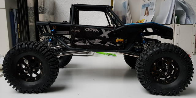

i moved the skid 1.5cm into the front
i shortened the front links for 1cm
i have to lengthen the rear links for 1cm
yes. tummy tucking
