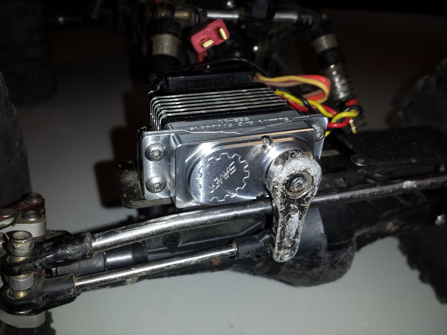

Here's a pic of my Sporty with a season new 7950. This thing is hammered.
Here's with the new Summit R/C cover. The rocks will have a much harder time gouging into the servo now.
