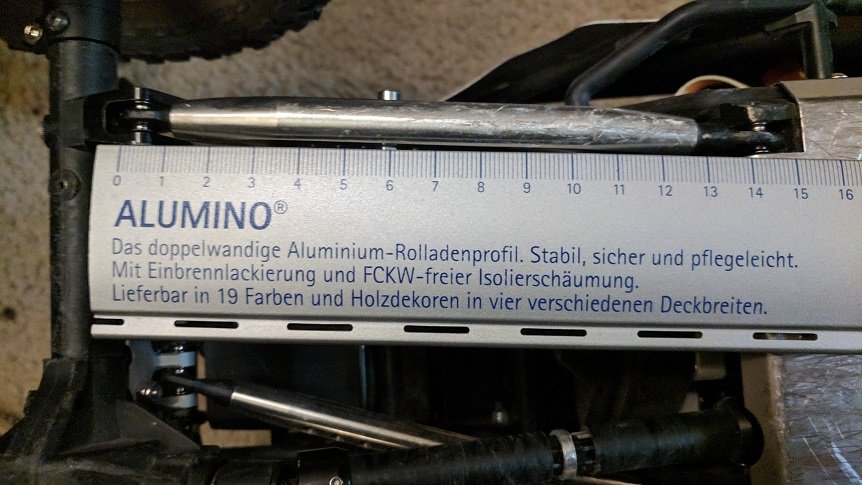

Here's what I've got

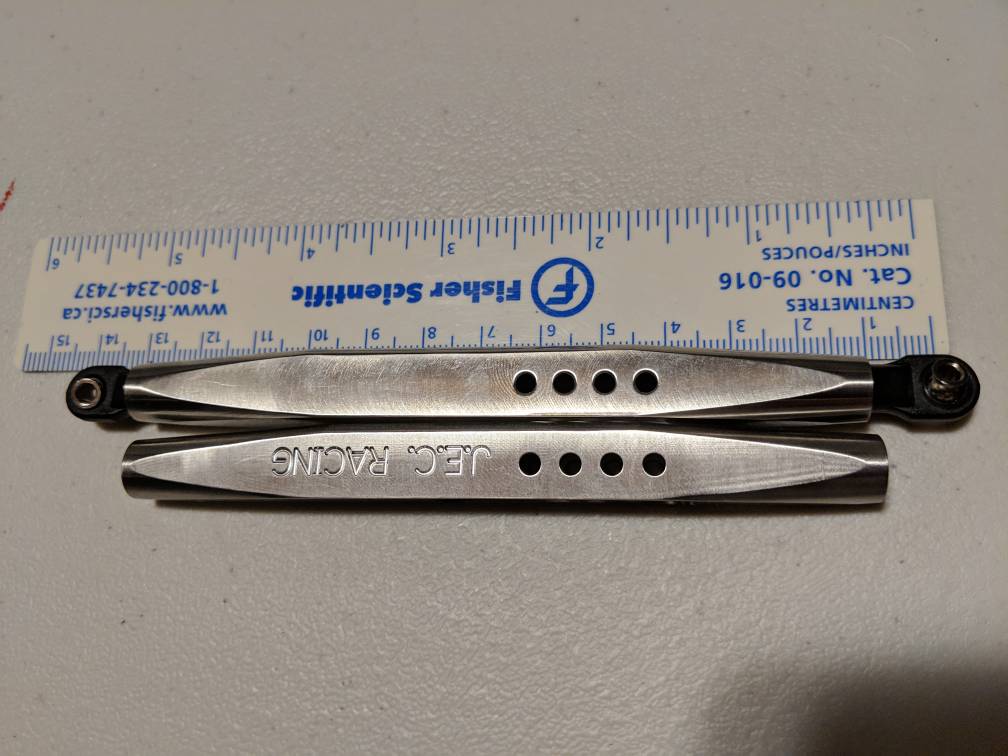

Well here's what I got both times as Wraith lenght

Maybe my traxxas rod ends are not screwed in enough?

When I get home I will try to remember to measure my Bomber SuperShafty JEC arms without the rod-ends. I know that JEC shortened the arms by a couple of mm to help with the pinion angle over stock.
Can you measure the arm only without rod ends?
Sent from my Pixel 2 XL using Tapatalk
Wraith - 115.25mm
Twin Hammers - 102.4mm
I will say that in the pic you posted of yours, the rod end on the right could probably be threaded in further. As I recall, the Bomber length JEC/SS trailing arms are a few mm shorter that stock to correct the pinion angle a little. I think this is what you have pictured.

Well damn, they are 115mm
I guess my rod ends need to go in a few more turns.
When I hold the next to the stock arms I swear they look almost identical.
