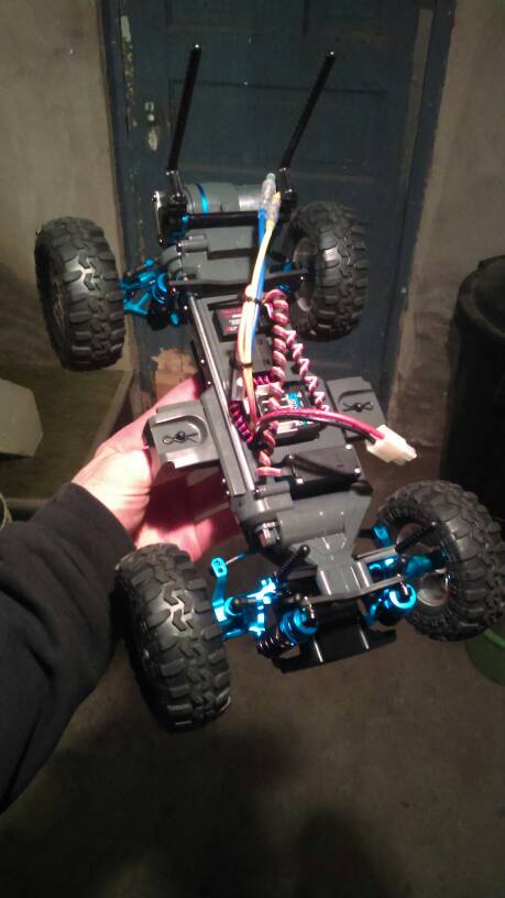

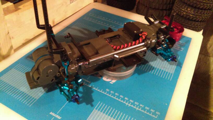

Finally got all my parts in .. so the build begins .

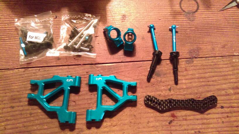

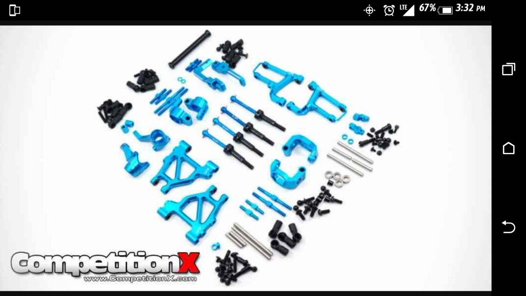

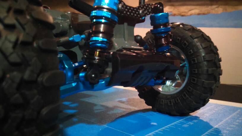

starting with almost all option parts available , bearings and alloy shocks .
Will be running slickrock 1.9 tsl's .:mrgreen:

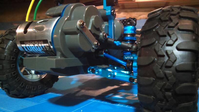

Rear different locked , alloy motor plate and carbon rear tower installed.

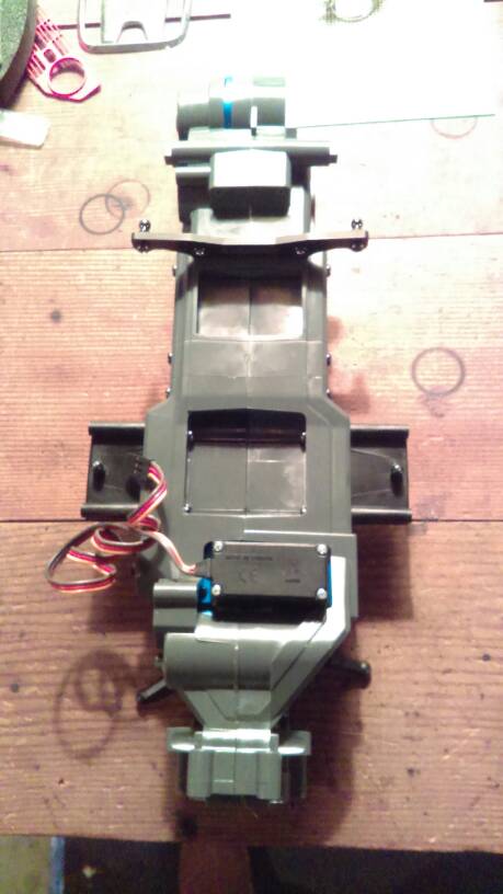

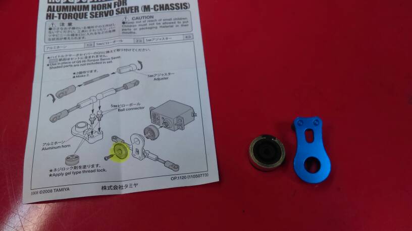

Aaron at rccarkings really helped me out with the yellow highlighted servo saver cap today and got to see a couple other MN crawlers members as well.

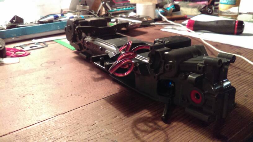

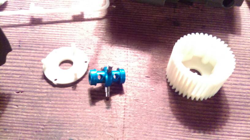

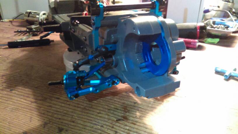

M05 yeah racing diff spool in the front and hot glued the rear. Shoulda got a second but it was an unplanned accessory.
Used savox 0251 from a buddy for $20

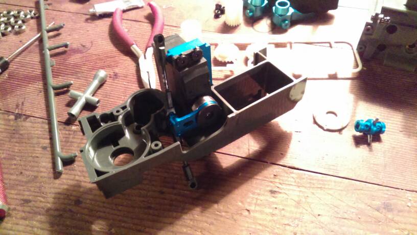

Mounted up in the alloy mount and installed in gearbox half.

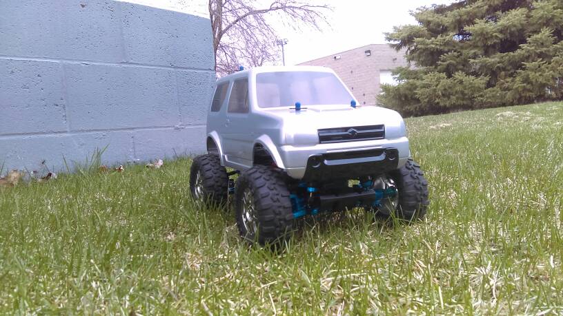

I'll be interested to know what you think of its handling. I built a rear-motor touring car and put a Porsche 911 body on it (because dammit, Porsche 911s *should* have the motor hanging off the rear axle, tuning problems be damned), but touring cars don't need forward weight bias to help them climb over stuff. I'm curious to see if this can actually run off-road on more than twigs and pebbles. It'll never be a proper crawler, of course, but I always like to see unconventional vehicles that can keep up.
So what's the plan...4S? 6S? Need to get some speed out of that little 540 motor...:mrgreen:
Actually thinking about going to a 35 or 55t motor. With its limited gearing options it's actually really fast with what I'd assume is some where around at 27t in the stock torque tuned silver can.
