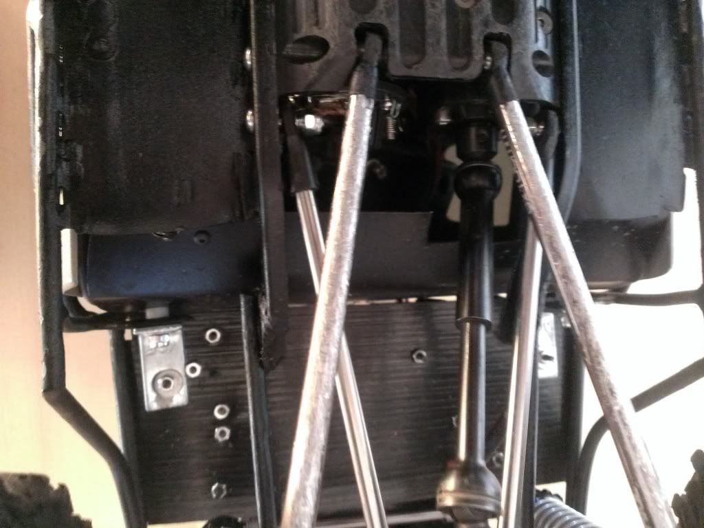

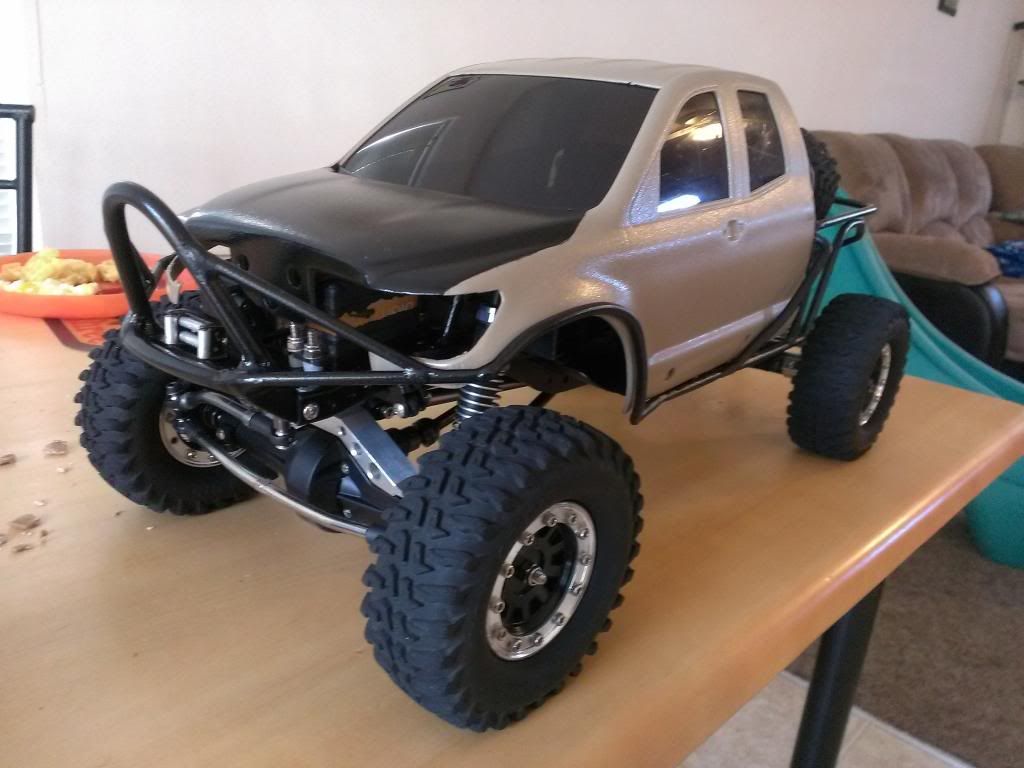

Only problem u will run into is that the cab isn't long enough so u will have to at least run a honcho bed to cover the frame my frame is cut at the back of the cab and then the tube back is welded to that and the plate sliders but just ask if u ever want any other pics of how far the body covers from the front of the frame to where it stops"thumbsup"

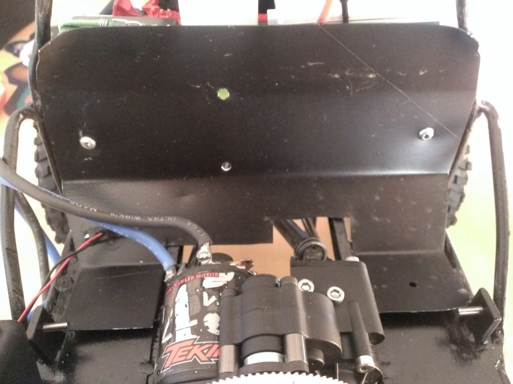

Here are some pics of how far the frame goes on the body obviously yours won't b cut off and what I did for the back of the cab was I made a plate out of thin steel and bent it to shape for what I wanted and I have a 4"x2"x1" radio shack project box that all my electronics go in that bolts onto the plate I made and I wasn't really worried about how it looked cuz I made a sheet of styrene look like wood and mounted all my scale stuff on it behind the cab between it and my spare and as I said let me know if u want any more pics or help"thumbsup"
