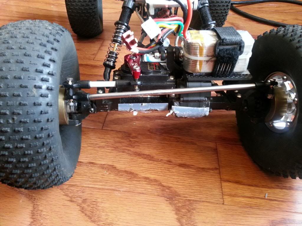

I recently went to this setup:
Here I need to lengthen the drag link a little so that it is perpendicular with the steering servo arm. THat will give me better movement with the short arm.
Using a 14mm eye to eye spacing on the holes in a very short servo arm. This solves my servo stalling problem completely, but it presents several other problems. First, is I don't have a tall offset mount servo arm, so my linkage has to go to the top of the servo arm. This is awkward and causes ball joints to be stressed a lot. Second, I'm going to have to mess with the drag link and it's length a good bit to get enough steering throw to take advantage of the bully 2 axles high amount of steering. You also lose a lot of control over the wheel at full right turn because of the steering arm is in line with the servo arm at full extension. I am happy with the steering link on top of the left knuckle, and then on bottom of the right knuckle. This give the most clearance for steering, and keeps the height of the stack on the right side down low to keep tires from snagging on it. I have tried this with the stock aluminum steering rod and then this tiny titanium rod. I ordered a 3/16" rod 160mm for use in the very near future.

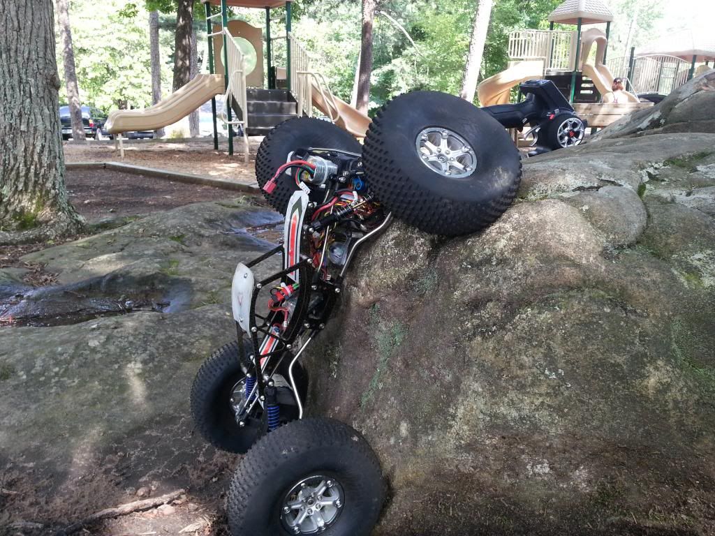

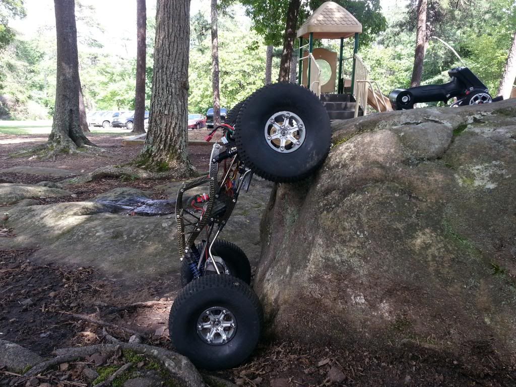

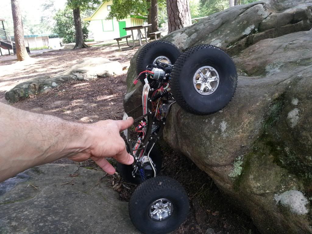

This rock is the vast majority (95%+) of my servo lock ups. It is representative of a particular type of crawl though.

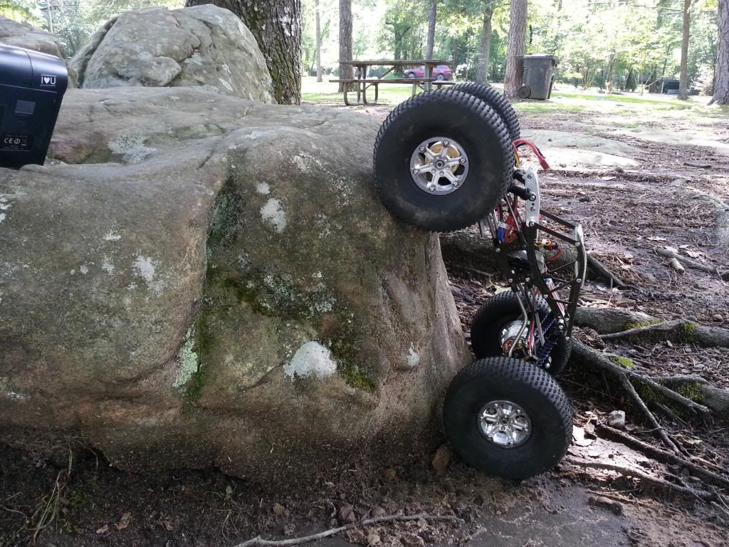

Here is a photo representative of what happens when I turn the wheels to get a leg up on the rock and pull over. This stretches out the chassis links/compresses the springs and locks the servo up.

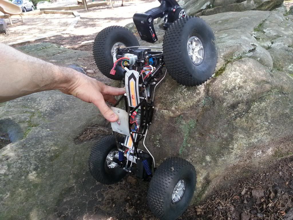

Here is another side of the rock that causes stall also, but not anymore:

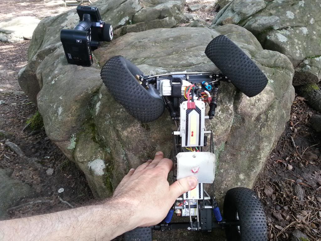

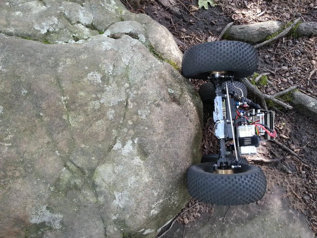

And here is a top shot that shows where i need to make the drag link more perpendicular to the servo arm to get better servo throw.
I did get a video, but it is uploading and I won't be able to get to it for a bit.
I'm trying to hold my phone and controller at the same time. Sorry for poor video.
This used to lock it up every time. I would still get over it, but my steering wasn't helping. Now I can move the steering as I get over it.

By the way, I think if you are stacking the rod end for the steering link on top of the knuckle link and then on top of the knuckle arm, you are missing the boat. Placing one of these links below the steering knuckle arm leaves much more room for tire deformation and NOT snagging a tire on the stack of links above the steering knuckle.
If that wasn't clear, look at the link that connects my knuckles. It isn't horizontal. That is better than placing it on top of both knuckles imo.
