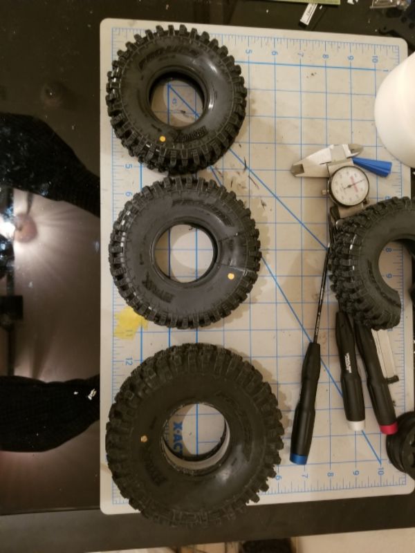

1.9 hyraxes turned into 5.125" 2.2's

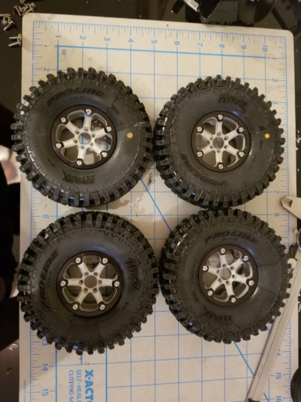

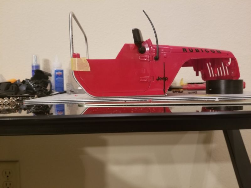

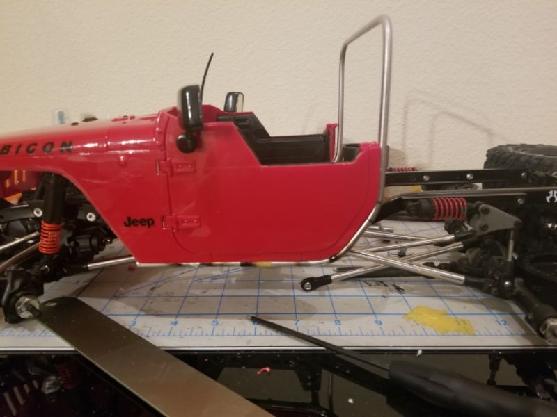

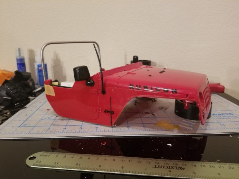

Time to shut up and post pics. Got the main roll hoop done today and brazed in. This took the longest since it'll be the "foundation" of the cage.
Minor update
Some more body parts fell off. A few more tubes were bent however they haven't been fully fit and brazed in. Had some minor family issues to deal with so I didn't have as much time as expected.

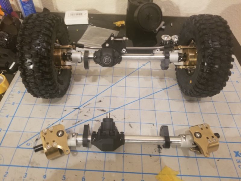

Axles got built though! Next week I need to design a panhard mount for the axle. Still iffy on trying it without a truss, or designing my own and incorporating into the mount. Link mounts not attached to the tubes yet, waiting to get chassis a little more done so I can mock it up fully. Also need to design some higher offset front wheels and hubs to narrow it up a bit. Currently at 11" wide, would like to be between 10.25 and 10.5". Also picked up some good condition, 2nd hand alum knuckles to put these on a bit of a diet. Assembled axle weight came in at right around 1lb 2.0oz.
