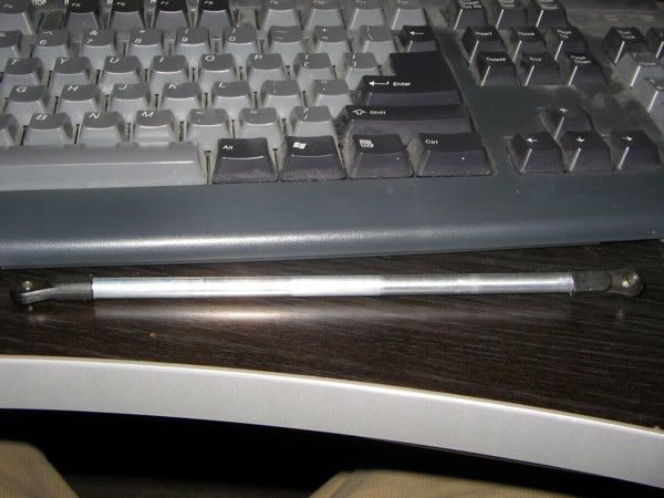

Ive come to the point where I need to drill and tap my links...
I bought some 8-32 threaded rod... but finding rod ends for that is near impossible...
So I guess I should go with 6-32 rod?
I used 10-32 all tread on mine for a while. I never had any problems. All I did was drill and tap some kyosho 6.8 ball ends. These links are living under another truck now and still holding up fine; even bent for high clearence. :shock:
yeah Im just having a hard time finding the 6.8mm Kyosho stuff...
The 6.8mm rod ends should fit the 8-32 threaded rod right?
You will have to drill and tap them. But it is alot easier than you think. Maybe 5 min. of work.
