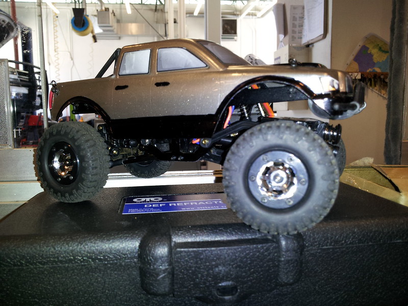

My TT as is currently sits

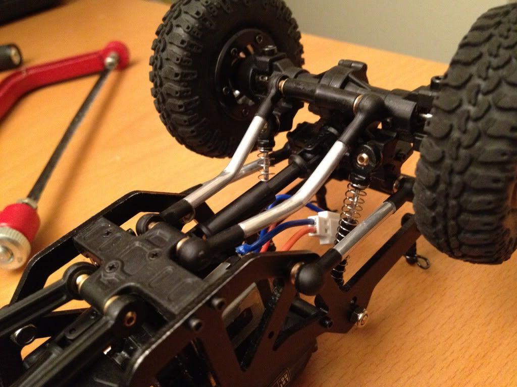

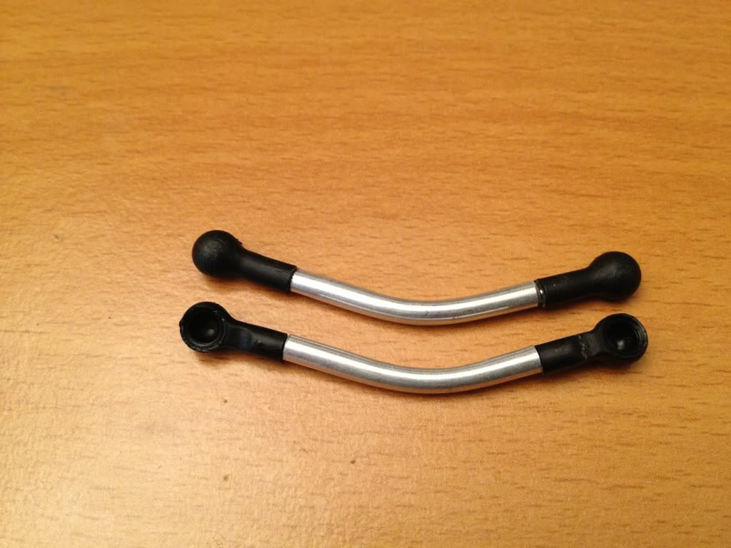

Rear Lower Links

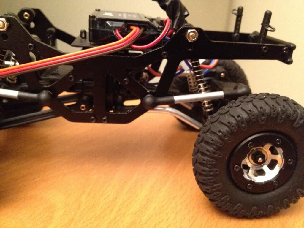

Rear Lower Links Installed

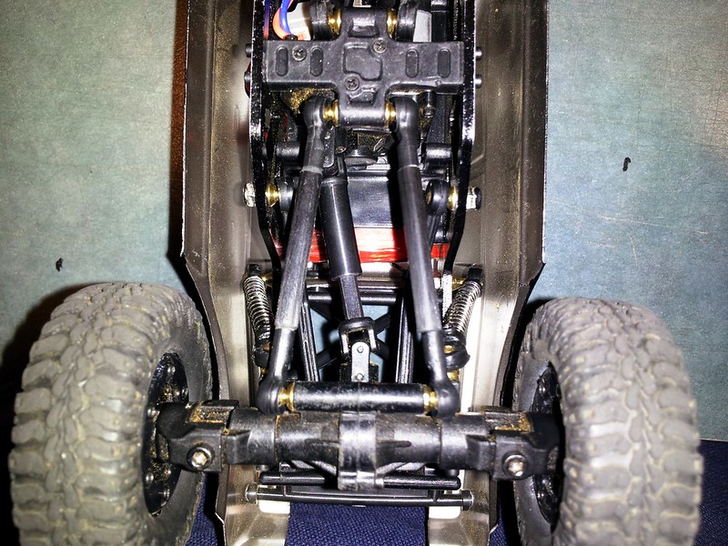

Upskirt of Rear Lower Links (and yes the rear links are inboarded and shocks outboarded)
