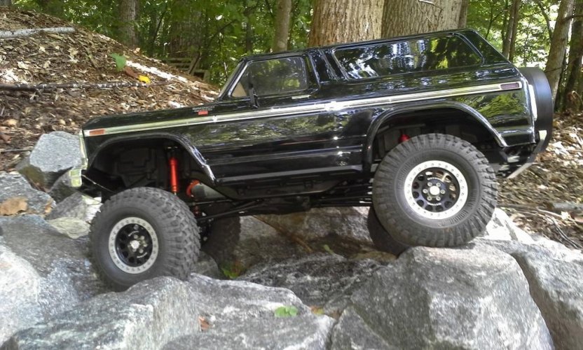

Love my TSL's... no clearance issues and work fantastic in the woods....mud.... well, pretty much anywhere.

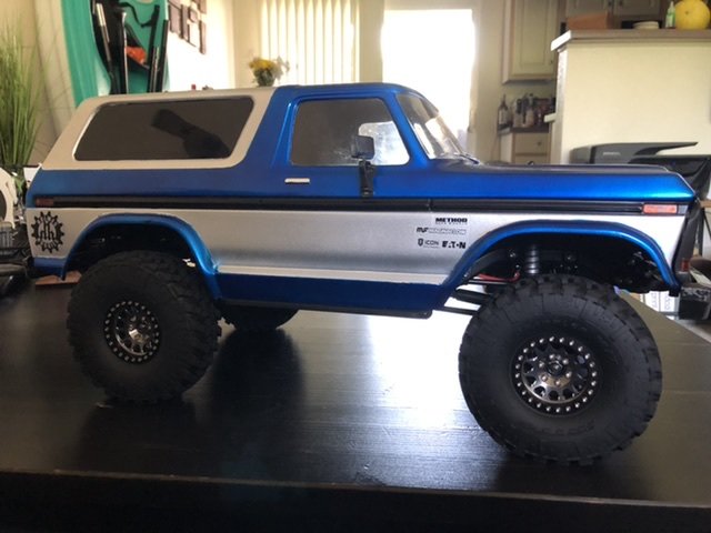

Running my scx10.3 nitto trail grapplers that are “4.7 inches” but really closer to 4.8 but I like the look and they don’t rub too bad

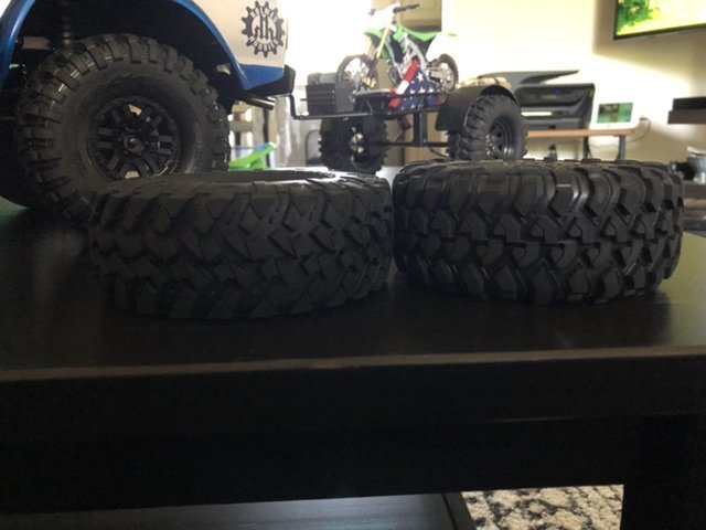

I have never had any clearance issues with the PitBull Growlers. I run the 1.9 tires on a 2.2 wheel.
