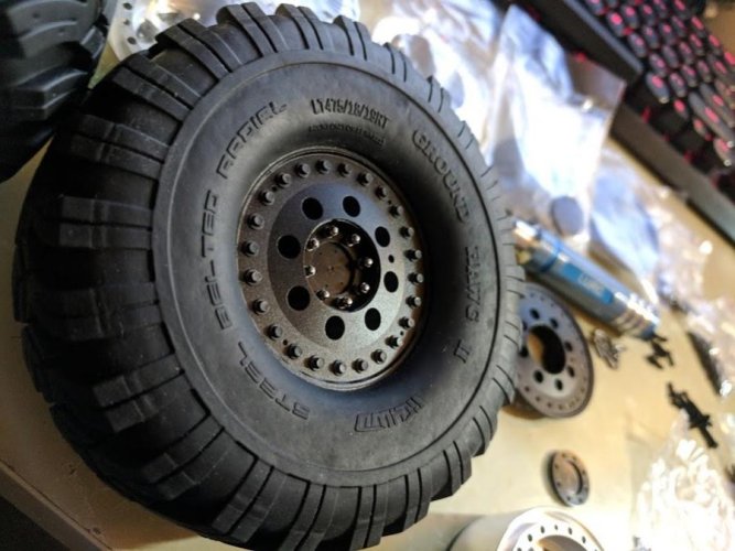

I have a set of LockedUpRC Hutchinson Command full-coverage beadlock ring wheels that would look great on a military styled one:
