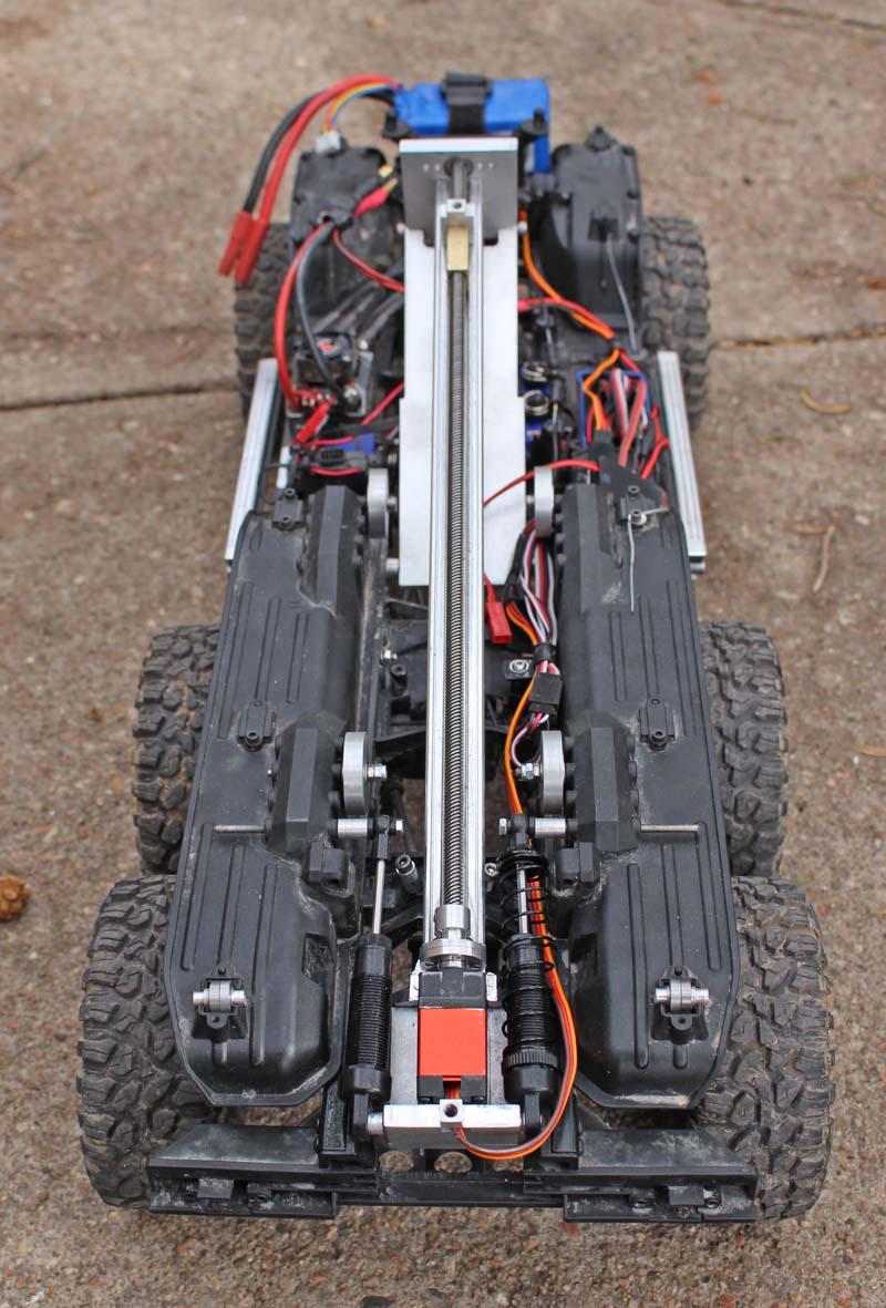

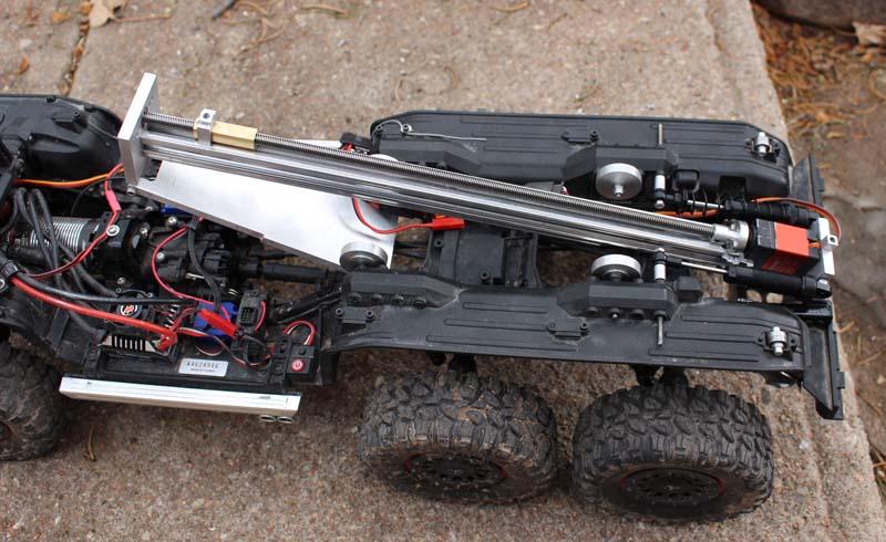

Been working on this for awhile. Tilt bed car hauler conversion. Action video coming.

Nice build. I'd love to see some detail shots of how you built that bed. I've been trying to figure out what to do with the back end of my cantilever TRX6

That definitely helps a little. Still looks like hieroglyphics to me though. I might have to wait until your action video to wrap my head around how it all works.

Awesome. The way you packaged everything in the center makes it look like the TRX4 was designed to work with this configuration. All I can see is the single additional servo at the rear; is that the only servo you added for this?
meatmonkey: I haven't weighed it. I did add a pair of cantilever shocks to the rear shocks.
DirtMerchant: The chassis lends itself well to the conversion. The stock battery tray tilts, so I swapped out the tray for aluminum plate which makes the other changes pretty straight forward. One rear servo is all I used.

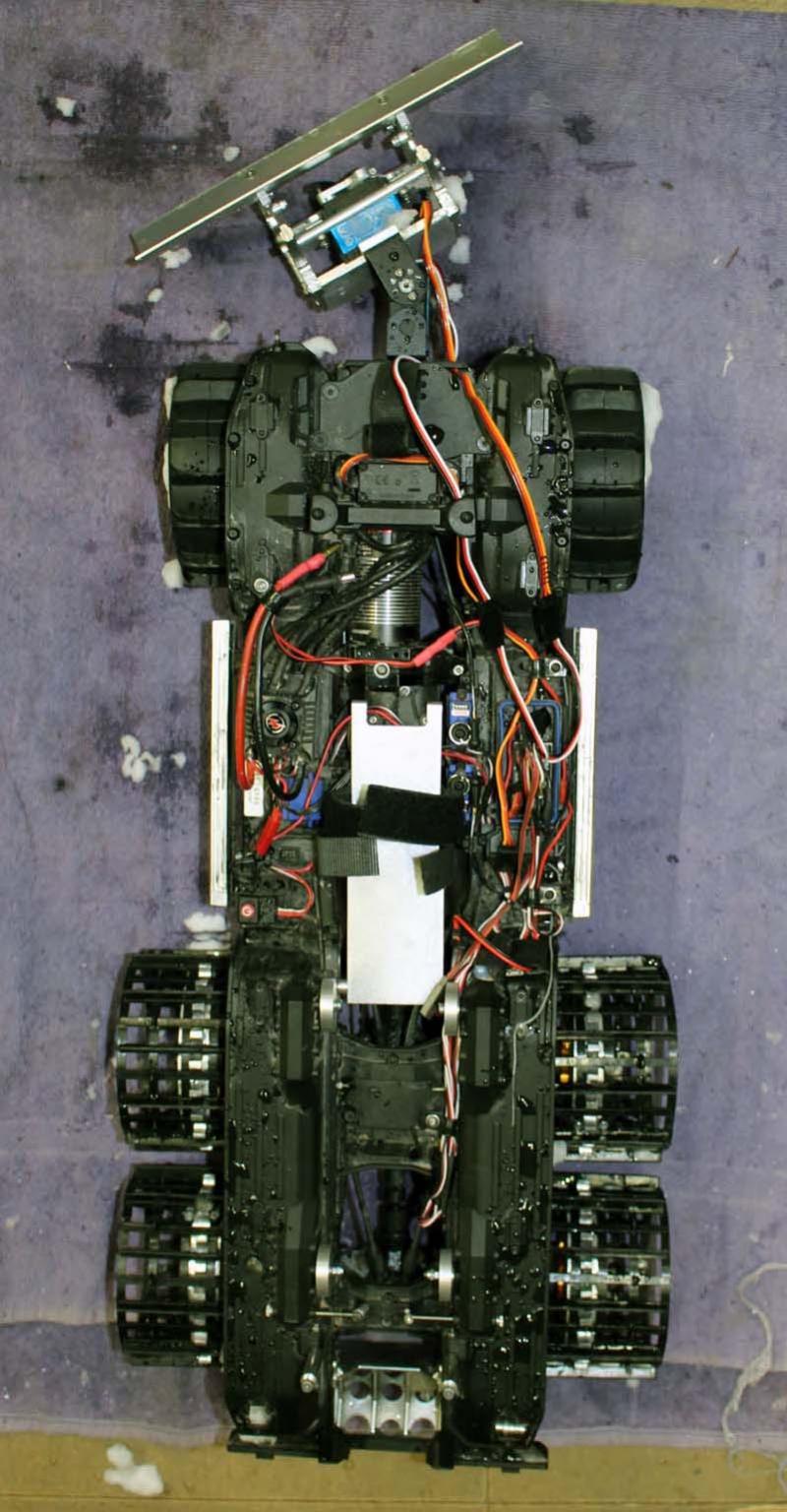

Here are a couple other mods I did.
I made a set of rear snowtracks and used front paddle tires for the snow.
Paddle tires front & rear for the soft sand/dirt.
Front snowplow attachment. The blade moves side to side and up & down.
