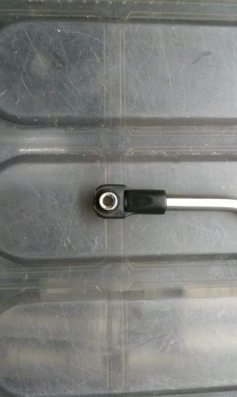

Something worth mentioning though, I, like many, prefer the use of the trusted revo rod ends. Sadly, on these scx2 axles, the revos will need a little shave job on the perimeter surrounding the pivot ball (just like what was necessary to use revo rod ends on the front lower link mounts onthe xr10). The lower link mounts have a bit of bind when the links are level (viewed from the side) and free up in movement as they articulate. The upper link mounts on the axle are another story though. They sort of have free movement rotating vertically, but have very little torsional freedom as the revo rod ends have to be positioned at about 15-20* within the mounting tabs. There is no significant loss of articulation (not within the confines of shock travel anyways). Sadly I feel this is a HUGE design flaw on Axial's behalf. Yes, the 4mm threaded rod ends they have now are better than the 3mm versions of old, but they still are made of the same soft, malleable plastic of old, and when it comes to performance and durability, nothing beats a revo rod end.
I have the Incision link set on my truck with the Revo ends so I experienced this as well. The axle housing required quite a bit of dremeling under the rod end to get the upper links to move freely.
The revos will need to be shaved similar to this to clear the lower link mouint. As far as the upper lnk mount, I will look into it more closely when I get back from vavation. I'd hate to clearance the axle housing too much.
