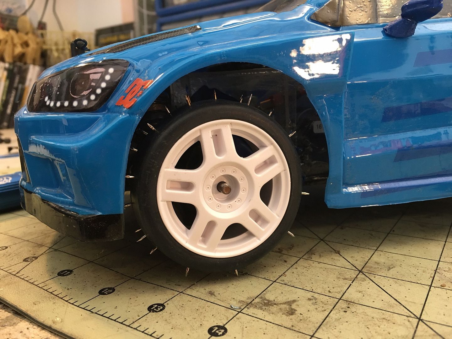

And I got the Volkswagen Polo R painted.
<a href="http://s34.photobucket.com/user/Typhoto/media/Rally/IMG_8235%20copy_zpsv0ldyoej.jpg.html" target="_blank"><img src="http://i34.photobucket.com/albums/d146/Typhoto/Rally/IMG_8235%20copy_zpsv0ldyoej.jpg" border="0" alt=" photo IMG_8235 copy_zpsv0ldyoej.jpg"/></a>
<a href="http://s34.photobucket.com/user/Typhoto/media/Rally/IMG_8240_zpsgx2pdtea.jpg.html" target="_blank"><img src="http://i34.photobucket.com/albums/d146/Typhoto/Rally/IMG_8240_zpsgx2pdtea.jpg" border="0" alt=" photo IMG_8240_zpsgx2pdtea.jpg"/></a>
<a href="http://s34.photobucket.com/user/Typhoto/media/Rally/IMG_8239_zpsfqm1fn3s.jpg.html" target="_blank"><img src="http://i34.photobucket.com/albums/d146/Typhoto/Rally/IMG_8239_zpsfqm1fn3s.jpg" border="0" alt=" photo IMG_8239_zpsfqm1fn3s.jpg"/></a>
<a href="http://s34.photobucket.com/user/Typhoto/media/Rally/IMG_8238_zpsidvflcaf.jpg.html" target="_blank"><img src="http://i34.photobucket.com/albums/d146/Typhoto/Rally/IMG_8238_zpsidvflcaf.jpg" border="0" alt=" photo IMG_8238_zpsidvflcaf.jpg"/></a>
<a href="http://s34.photobucket.com/user/Typhoto/media/Rally/IMG_8236%20copy_zpspojhykd0.jpg.html" target="_blank"><img src="http://i34.photobucket.com/albums/d146/Typhoto/Rally/IMG_8236%20copy_zpspojhykd0.jpg" border="0" alt=" photo IMG_8236 copy_zpspojhykd0.jpg"/></a>
<a href="http://s34.photobucket.com/user/Typhoto/media/Rally/IMG_8237_zpsu4pevznv.jpg.html" target="_blank"><img src="http://i34.photobucket.com/albums/d146/Typhoto/Rally/IMG_8237_zpsu4pevznv.jpg" border="0" alt=" photo IMG_8237_zpsu4pevznv.jpg"/></a>

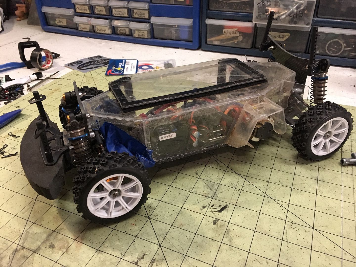

I got all the electronics in and the underbody pretty much buttoned up.
<a href="http://s34.photobucket.com/user/Typhoto/media/Rally/IMG_8219_zpslr2gboju.jpg.html" target="_blank"><img src="http://i34.photobucket.com/albums/d146/Typhoto/Rally/IMG_8219_zpslr2gboju.jpg" border="0" alt=" photo IMG_8219_zpslr2gboju.jpg"/></a>
<a href="http://s34.photobucket.com/user/Typhoto/media/Rally/IMG_8317_zpsusbe5g6c.jpg.html" target="_blank"><img src="http://i34.photobucket.com/albums/d146/Typhoto/Rally/IMG_8317_zpsusbe5g6c.jpg" border="0" alt=" photo IMG_8317_zpsusbe5g6c.jpg"/></a>
<a href="http://s34.photobucket.com/user/Typhoto/media/Rally/IMG_8315_zpsc0d4kvq2.jpg.html" target="_blank"><img src="http://i34.photobucket.com/albums/d146/Typhoto/Rally/IMG_8315_zpsc0d4kvq2.jpg" border="0" alt=" photo IMG_8315_zpsc0d4kvq2.jpg"/></a>
<a href="http://s34.photobucket.com/user/Typhoto/media/Rally/IMG_8316_zpsbgxdd5ms.jpg.html" target="_blank"><img src="http://i34.photobucket.com/albums/d146/Typhoto/Rally/IMG_8316_zpsbgxdd5ms.jpg" border="0" alt=" photo IMG_8316_zpsbgxdd5ms.jpg"/></a>

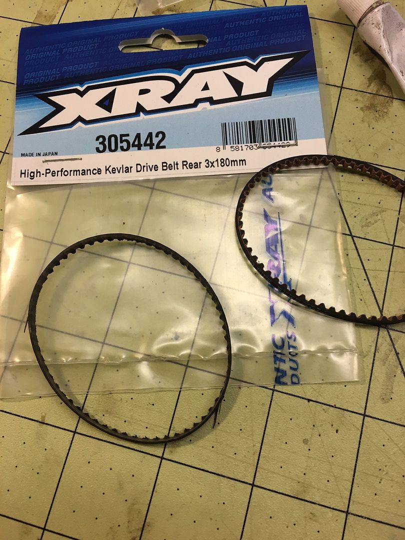

First thing I did was swap out the old belts.

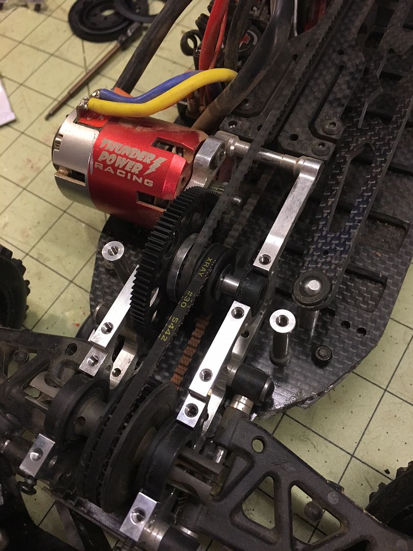

Next I swapped the 64 pitch gears for 48 pitch.
