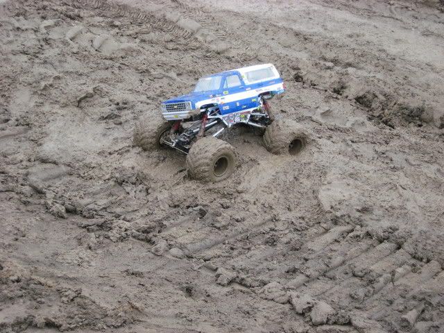

stock (crap tires) two 45 turn motors both diffs locked....that mud stole my shoe!.
