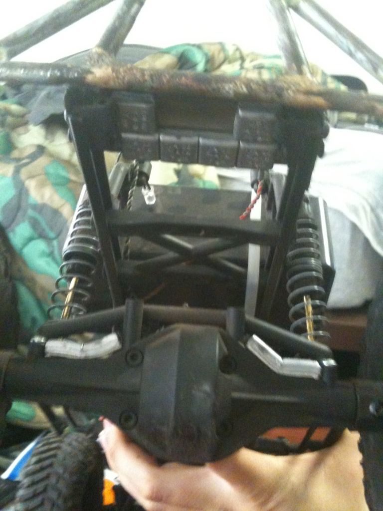

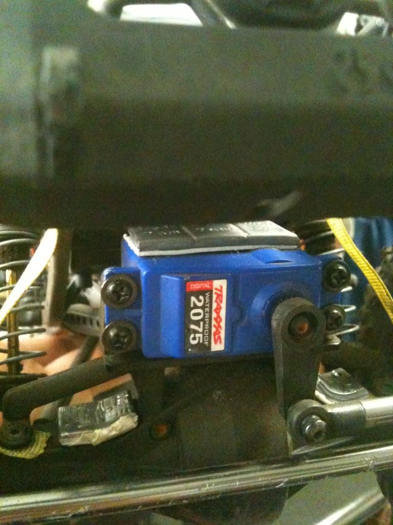

here is what ive done to avoid wheel wieght
"thumbsup"
