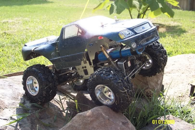

I used a stealth tranny in Fungus ( http://www.rcpics.net/img/61865 ). I have another rig with a pede in it aswell. In all honesty I like the stealth better. I hollowed out some traxxas yokes and drilled some holes for pin mounting ( http://www.rcpics.net/img/61632 ) and the thing works great (I'm not down with searching for dogbones.) The whole thing is half the weight of the pede and the gears hold up amazingly. I'm running a 15/87 gearing ( great wheels speed and perfect torque with a 55t of course.) Hope thats in any way helpful.
