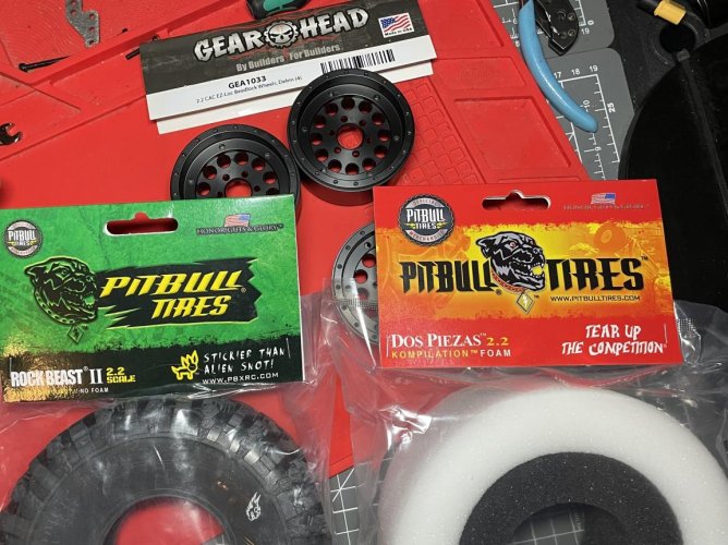

My "crawler" set of 2.2 wheels/tires/foams has arrived. These Pitbull foams are half the price of the crawler innovations. I haven't mounted any yet, but just squeezing them, I can tell they're probably not what you want for a ryft. I'll give you a comparison with my other set when I'm done mounting these.

The dos Piezas Are well priced, Look good, but I think you're correct, a bit too soft and not firm enough for a tall sidewall. JM2C from Looking.
But Yes a personal experience test is always better suited.
ya Ferp< I considered that, but as you likely summized, they'd not be too suited for speed. I can imagine they may be pretty unbalanced. unless set absolutely perfect. and even then.
I will likey end up balancing the wheels for the Ryft as it will see some speeds, and a balanced wheel keeps things way more controllable while bouncing along at speeds.
Good info/input so far. Keep it going. I'm sure I wont be the only one with this question on the Ryft.

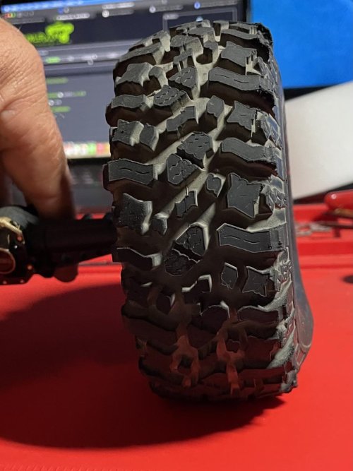

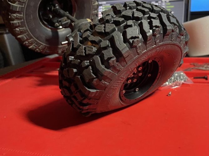

Dirty:
2.2 Rock Beast II Komp Kompound
CI Double Deuce 6.0" Heavy Weight Comp Cut Inner / Medium Outer
SSD Wheels
Clean:
2.2 Rock Beast II Alien Kompound
Pit Bull Dos Piezas Dual Stage Foams
Gear Head Wheels
I mounted one of each on an ar44. I think I actually added more side pressure to the wheel with CI foams... I had to grip the opposite wheel to add down pressure so it wouldn't just slide off the mat. Can't wait to get the aliens on the rocks!
Pressing straight down on the pumpkin, they seem to have about the same resistance to gravity (until the CI outer bottoms out on the heavyweight inner). Neither one wanted to flatten out completely.
Hope this helps.

Yes, Helps very much so. Being able to visualize how they set on load is great.
Thanks Much for the pics and descriptions.
So ya, the Dos Pieza's do appear to be too soft for good speed runs, but great for rocks as they look like they'll conform well.
Out of the cart they go. lol
