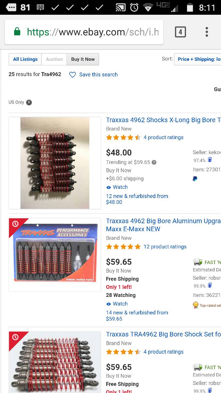

Traxxas big bores FTW! Best deal is tra4962 which comes with enough to do 2 rigs for $60.

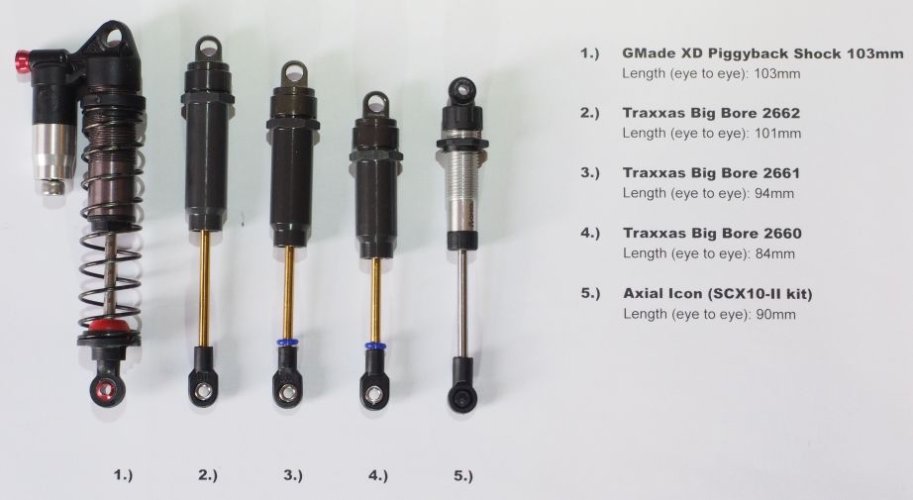

Are big bores okay length wise for the SCX10? I thought they might be a bit long?
Cheers
Simon
Not exactly the same, but you can choose a tad longer or shorter:
14mm Axial springs work fine on the Traxxas shocks with (Traxxas) spring collars. 12.5mm springs (as used on the SCX10-2 kits) work on Traxxas shocks without collar but will rub the shock body slightly.
Great info, I've used the shorter Traxxas BB on a build, nice options.
