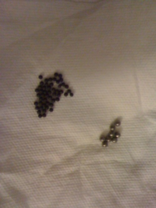

This is a pic of 8 grams of lead bird shot and 8 grams of tungsten BBs. The reason for this picture is I had a thought...an observation...a theory about the friction caused by all those small pellets of lead rubbing together inside the tires. When I weighted my tires a while ago with lead I noticed a dramatic increase on how well the crawler performed, but I also noticed that my battery life was decreased. Im sure the fact that the motor was pushing more weight uphill is a factor, but I suspected more was at play.
I started researching on RCC for what other peeps here are using for wheel weight and all that. Lead shot and BBs (steel/zinc) seems the most popular for dynamic weight. Lead weights and solder inside wheel are the most popular static weight options. Now I have had a run in with a lead weight when I first got my micro. I had a weight fall off and I thought the dog ate it and I really didnt wanna have to call my girlfriend and tell her that the dog she just spent 5000 in vet bills on is going to die a slow painful death within the week. So I started thinking of other nontoxic options.
Tungsten came to mind and I started looking for suppliers of BBs and stuff. Tungsten is 40% more dense than lead and about 3 times more dense than steel. Less material is less friction due to less surface area rubbing together.
Spin test... I had 2 wheels and tires mounted. 1 with 8 grams of lead shot and 1 with 8 grams of tungsten BBs. My thoughts on that was that the tungsten would spin alot better due to friction and I was right. I didnt get 2 turns with the lead and I got maybe 6 with tungsten. and when I spun it really fast the lead would just centrofuge to the wheel and tungsten keppt rolling around in there.
Cost/benefit factor... I dont know. none really... 1oz of tungsten BBs was 5 bucks plus shipping. lead is friggin dirt cheap. The real benfits are increased battery life and the fact I dont have rogue toxins in apartment that stupid doggies can eat if lost. People with small children could also relate to that. Not that Im calling your children stupid...but that they tend to eat anything on the floor. ...you get me.

this is actually interesting. I know I use a combination of steel bb's, lead solder wrap, and BWD wheel weights. I have debated about using lead shot but as you said kids eat anything off the floor. So this is a nice option. I am curious on standard steel bb weight compared to the lead and the tungsten. You have any laying around you could do some comparison with?
I have looked into the weight of a single steel/zinc BB. They weigh 5 grains. 15 grains = 1 gram. so thats 3 BBs to a gram. The .190mm or 3/16inch tungsten BBs I got are .9 to 1 gram each. You can pull up a density chart here..
http://www.engineeringtoolbox.com/metal-alloys-densities-d_50.html
As you can see, tungsten is the best heavy metal option without spending CRAP LOADS of cash on gold or platinum or getting onto an NSA terrorist suspect list with the uranium.

anything larger than 5mm will be too big for a micro tire. keep in mind that a regular BB is .177 inch. 5mm is almost .2inch or in the area of 3/16.
