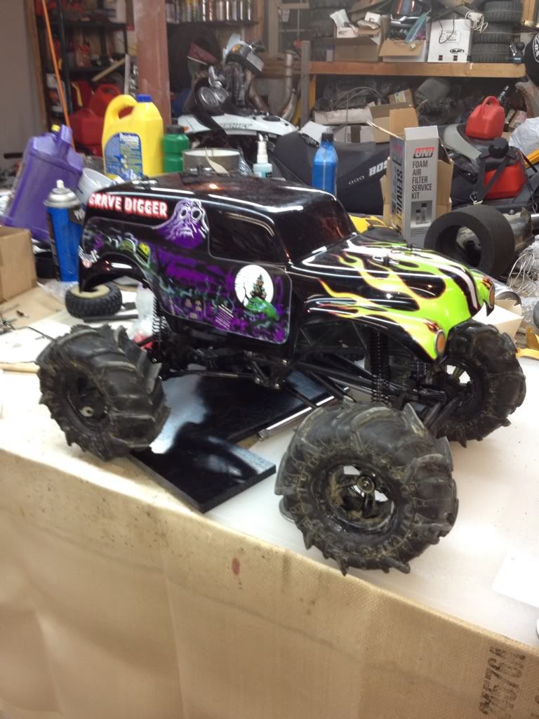

Turned a wheely king rock racer project into a Gravedigger....Everyone needs a monster in their stable somewhere. :) Used a VXL so I could run full bore, and then turn it down 50% for the kids to play. This truck started off as a 2wd OG WK years ago and has been modded constantly over the years....probalby the 6th or 7th incarnation of it.
VXL/2S
32p gear conversion
Wraith swaybars
Custom chassis and servo mount from 2mm 6061
3Racing CR01 shocks w/CK black springs
HD RP gears front and rear
Aluminum center tranny gears
Shaved Duratrax MT tires and wheels
Botched the decals up front, but good enough for a 6 year old. Realized I never put the window decals on...oops. So have some more details to finish up, but had to take it for a test run :) Ran awesome, the swaybars were the best addition I made. Totally under control and just enough roll for a scale monster look.
Chassis work:
Posers:
Some random action shots - super fun to drive...been a while since I went over 5mph. Geared a little low, have to work to keep the fronts on the ground so the wheely bar will most likey end up back on the back. Soaks up the landings like a champ! Just a tiny bit of bounce from the tires.

The swaybars are an HR set for the wraith. Defintely helps a ton - that's a rather heavy body up there.

Did you make the chassis yourself? Great looking MT"thumbsup"
yup....had some leftover 6061 and was playing around 1 day.
