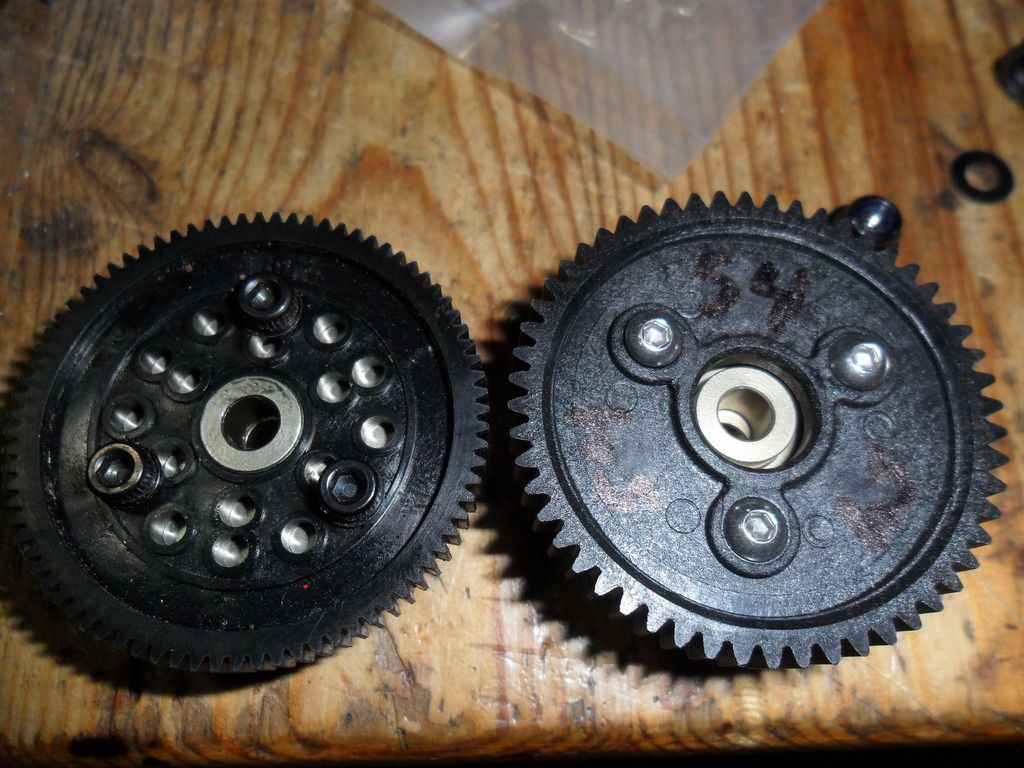

Yes 32P is more beefy. Here is a comparison of gears for the Wraith exactly like you're asking. 32p is on the right, 48p is left. People switch to 32p on the basis of stripping 48p gears with too much power.
