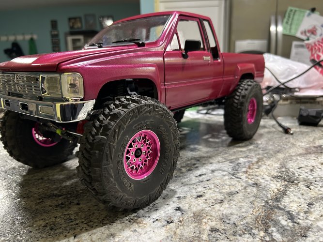

The body paint is electric pink from testors. It looks good, I just wish it was more hot pink lie she likes. The wheels are the color she really likes but she said she likes the body. And it’s good too, because these bodies are a pita to put together lol.

Quick update to the truck. Tire size was so wrong before with the Kevlars so I went down to a 4.19.
These tires fit the build much better and keeps me from having to trim the wheel wells.

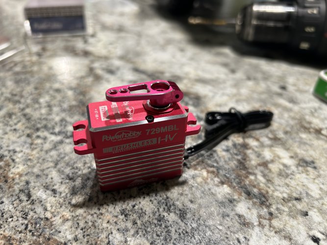

One of the most waited on parts came for this rig. I was searching and searching for one and came up with nothing.
I contemplated yanking the nsdrc special edition boobie (breast cancer) servo out of my scale tacoma build but just couldn’t do it.
Powerhobby had just the one I needed! This one will work fine with 500oz torque and a pink servo horn to boot!
Now, I can hook up all the electronics. Gt5 tx and shift servos and steering. Need to do an indoor test run with it for the body clearance and see how that is. Excited it’s coming together!
