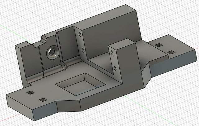

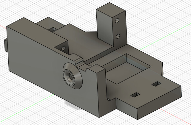

I REALLY wanted a bolt-on solution here, but in the end, I have made my own mount...
Screenshot 2025-05-18 125708 by Scott O, on Flickr
Screenshot 2025-05-18 125804 by Scott O, on Flickr

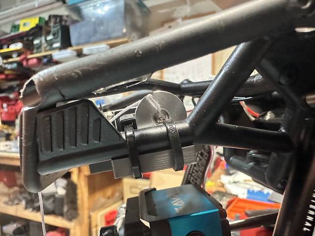

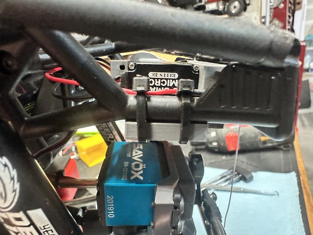

This zipties under the X-brace to the two frame rails, and bumps up to the light bezel LED retainer screws.
As designed, it will poop out the line about 10mm inboard of the left headlight.
Most certainly not the prettiest thing I have designed, but it will be hidden under the hood, so its aesthetics can be lacking as long as it works.
It is not 100% done, I am still waiting on the spool for my micro servo, and I will likely have to move the fairlead over a little bit. For some stupid reason I thought a $90 micro winch would come with a spool... 😕

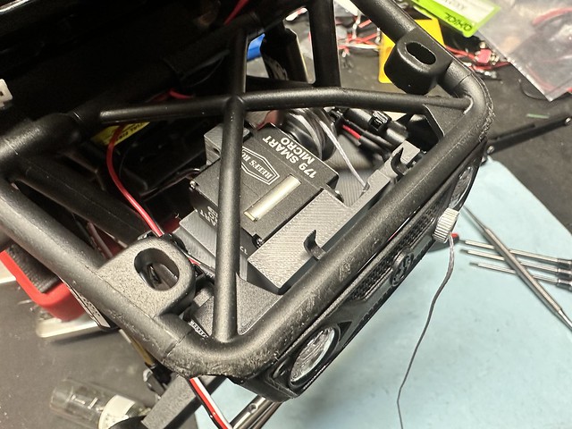

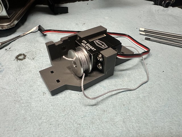

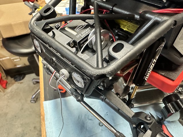

Well, I have a spool, and I programmer now, and starting the process of getting the winch installed.
I made a few more tweaks on the design, but it basically the same. It is still uglier than my brother's 9th-grade girl friend, however, like her, it will get the job done.

I should get the whole mess wired up tomorrow and have it out for some testing.
