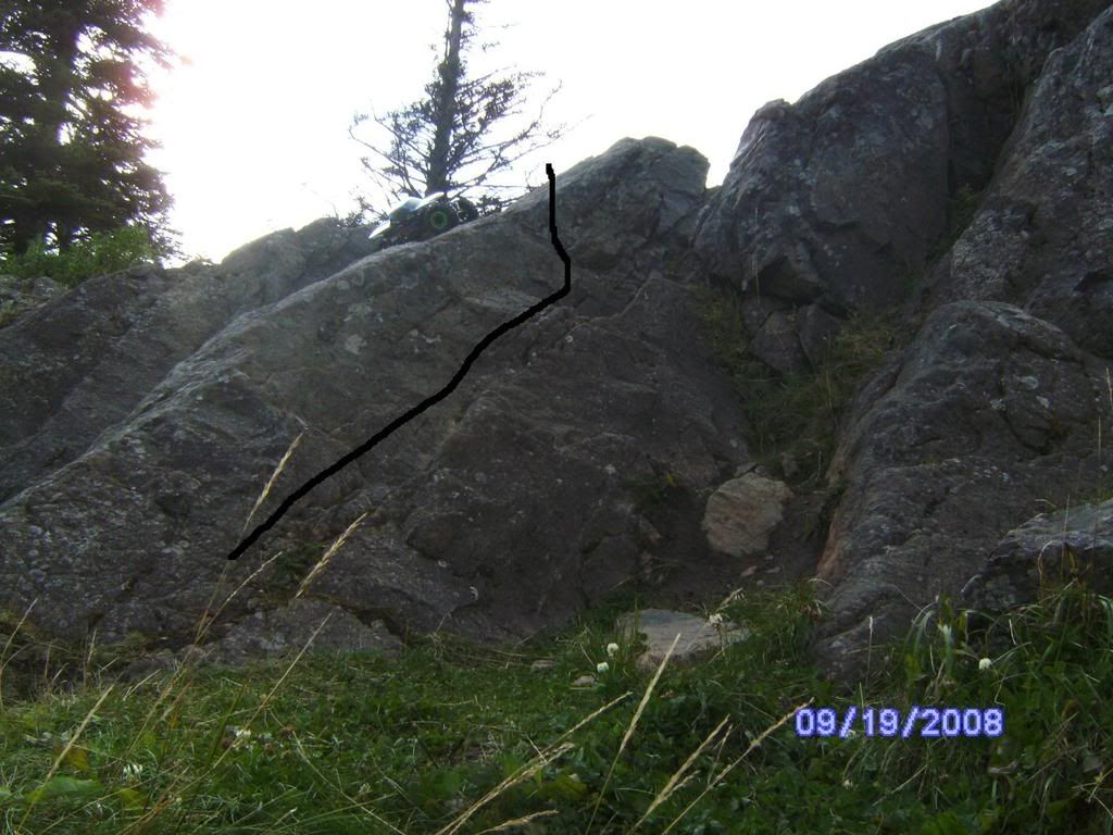

And here is some testing on the rocks.
The next vid is this line:
This a very capable rig on the cheap. I'll post a new vid tomorrow with the new mod motor and battery.
